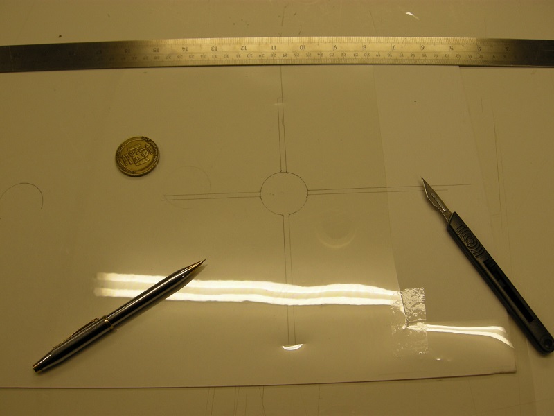

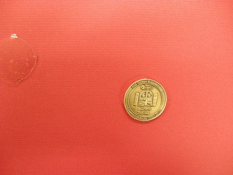

As for the coin type medals a shaped melinex mount would be good .....
Trace the shape and add 'legs'. Tape a sheet of melinex over it and carefully cut the shape out - aiming to cut juuuuust inside the pencil line on the curves
Cut it out completely so that you have a template to position and mark where the legs will pass through the mounting board
Pass them through the board and position the object.
Adjust, tighten and tape the legs down at the back - that's it mounted (to the left is one I did earlier)!

A brilliant tutorial.
- StevenG
- Posts: 1180
- Location: Tyrone, N.Ireland
Re: Fixing military medals
No messing, straight to the point. Excellent.
Class!
If you have a CMC you can cut melinex shapes with anal precision by putting the sheet of melinex under a mount board offcut and increasing the blade depth a fraction - assuming you/your software is capable, mine isn't and I'm not!
Thanks fantastic! Didn't expect a full tutorial!
Nobody expects the Full Tutorial! Our chief weapon is surprise. Surprise and fear. Our two weapons...............
- Posts: 2998
- Location: Bristol
- Location: Bristol
Well done John (Robo) 1st class tutorial
Well thanks all, but it was quicker than trying to explain it!
Very nice job that!
One imagines there is no adverse reflections, once glazed?
My chums find ancient silver and gold coins (when lucky detecting!), would the plastic take anything away from the surface patina?
Possibly, but going by the above obviously unprofessional photos, what say you?
