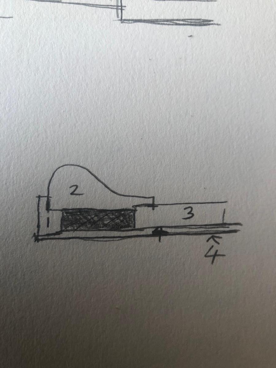

You could also cut a flat profile on its side, something you already have in stock - and cap it with any moulding you like. If not hand finished then mouldings can still match and look meant to be, or even contrast.
1. Flat profile
2. Moulding
3. Canvas
4. Backing board - can be on or in the frame.
Shaded area could be filled but not essential
1. Flat profile
2. Moulding
3. Canvas
