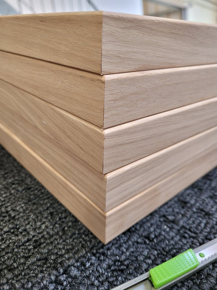

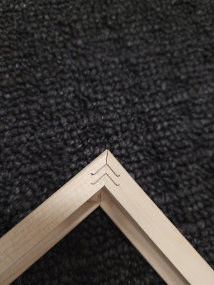

I am brand new to the framing world, and had a sure belief that there should not be many problems in a 90 degree joint. however, I have had some issues that I think stem from my underpinnings. The corners of the frame can be assembled perfectly on a table, but when I put a clip in, I see a small gap, the same length as the clip is, if I slide the clip in from the front of the frame, then the problem is moved to the front of the frame , and therefore I do not think it is due to the cut of the frame.
as I said, I am brand new to this world and all the help, tips and anything else I can get will be greatly appreciated.
my underpinner is an AMP U-400. I use the original "power twist" clips, I have "soft" and "medium" clips, and I have generally only done tests with soft, since my frames are soft, I have 6,5 bar into the machine, from the compressor system, and I have set the machine to anything between 2 and 6,5 bar during different tests, but I did not think there are any regularities in the joints. my current frame size is 15mm wide and 20-25mm high.
thanks in advance.
from a new frame maker.
thanks in advance.
- Gesso&Bole
- Posts: 952
- Location: Nottingham
Re: New to framing - Corner gap, maybe underpinner
Morning Brian, and welcome to the Forum.
Have you tried putting just 1 wedge in each corner?
All of the underpinner manufacturers show putting lots of wedges in, because they sell wedges, and are keen for more repeat business. I find that too many wedges pushes the corner apart, and in that size of moulding would use a good quality glue, and one wedge, slightly closer to the inside edge than the outside.
Let us know how you get on
Jim
Jim
- Posts: 1881
Hi Brian,
These look great!
Do you have adjustable fences? If so try tilting the fence a tiny bit back.
Try placing the front wedge as close to the front inside as possible and place your back wedge a tiny bit further forward. If you are leaving these as barewood find a wood filler that matches.
These look great!
- Posts: 11020
Hi Brian and welcome to the forum,
Well, you have not done badly so far and some small gaps as shown in your pictures are not all that unusual. Some softer wood types will compress a little to accomodate the extra thickness of the inserted wedges, or clips as you call them, but many types of wood do not compress enough to avoid the small gaps appearing as a result of the wood swelling due to the added thickness resulting from the thickness of the wedge material. This does not necessarily mean that you've done something wrong at all.
Some mouldings are suppled with a manufacturers factory finish of one sort, or another and in such cases it is quite usual to fill the gap with a colour matching filler, these are typically supplied in small tubes or tins by picture framing trade suppliers. Most picture framers will have a suitable range of different colours of these fillers to suit their needs. Some framers prefer to use bare wood (unfinished) picture frame mouldings and sometimes it is possible to mix different colours of these coloured fillers to match well with the natural colour of the wood, even just to fill the gaps with a little wet PVA glue and sand the bare wood a little, so that the saw dust (which is the same colour) mixes with the clear drying wood glue to fill and hide the gap.
There is nothing particularly unusual about needing to do this at all, but it might take you a little practice at first.
Best wishes.
Best wishes.

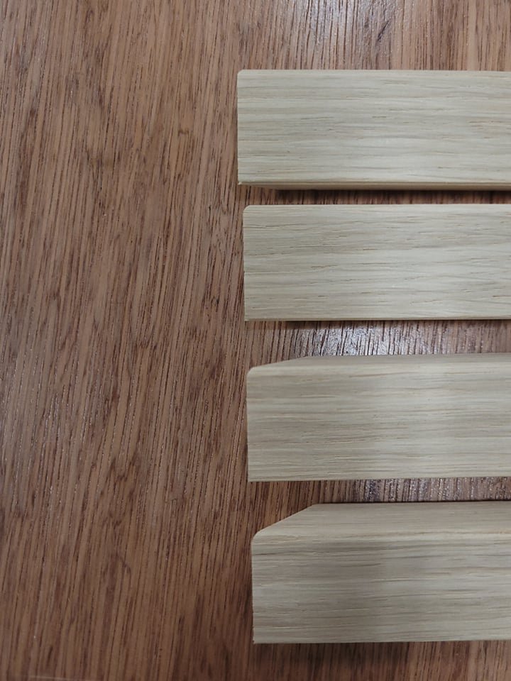

I'd say it's always the Morso cut. The underpinner just joins up what you have cut.
You're holding the moulding down as best you can when cutting. Even the slightest wobble can throw things off.
Clean the underside of the moulding with some fine sand paper and use only a shaving cut as your final cut.
