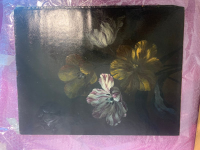

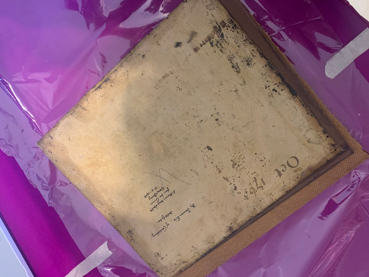

Hi there,
I have a customer with 3 very delicate and precious paintings from 1765 that have been preserved. I am trying to figure out how to go about framing them in the safest way. They are all oil but vary slightly, one of them is oil on paper, another is paper on card and the heaviest is paper on panel. They are the following in size:
282 x 254mm - paper
383 x 300mm - paper on card
383 x 300mm - paper on panel
They have all been preserved and spray varnished with Laropal K80 Resin/ Stoddard solvent, which has made them quite reflective already due to the dark backgrounds but I think they would be safer behind UV glass rather than framed in tray frames. Would that be the right thing to do?
The customer would like a very simple frame, I was thinking a box frame with a lay on museum board mount, fillets and high quality UV glass to protect the artwork but I am not sure how to safely attach them to the mount? (especially the heaviest paper on panel piece) Or would a tray frame be ok?
Thanks in advance!

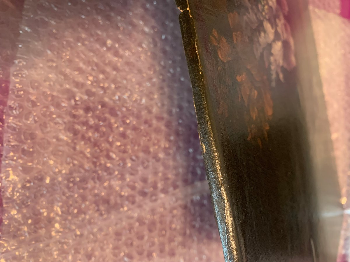

Thank you! Yes looking at the artworks I thought the customer would like to go in a more traditional direction but they want to have a contemporary style with a very slim face box frame.
My main concern is what material to use to attach the paintings to the museum mount board behind the artworks as there is history on the back of the paintings and 2 of them are also quite heavy on card and panel. I don't think that the acid free tape will be strong enough to attach the heavier pieces but I want to use the most reversible/ kind materials possible that are also strong enough to keep them in place on a mount board. Is there anything that you would recommend to attach them to the mount as a lay on so the delicate edges are visible?

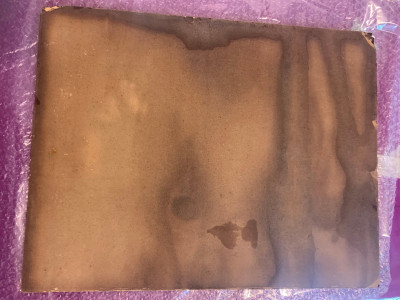

I'm a bit suspicious of the provenance of these art works. Two things would worry me.
I'm judging from the photos that the backing board appears to be a cheap pre-war cardboard, and -
Items that have a genuine provenance and value rarely declare the date in such an ostentatious fashion.
But I might be totally wrong and so what. They don't belong to you and all you need to do is frame them to your customer's satisfaction.

Thank you so much for the advice, especially the platform mounting. I have looked it up and that will definitely be useful. Is there a way the edges of the paintings could be visible in platform mounting? It looks like the outer mount would sit on top of the paintings. Would the delicate uneven edges of the paintings in platform framing be ok? The largest difference in size on one side is 8mm, would that create room for movement behind the mount if they're quite uneven?
Sorry for all the questions! I'm a little stuck and just want to do the artworks justice and keep them well looked after after all these years whilst working with with the customers modern look brief.
Thanks again!

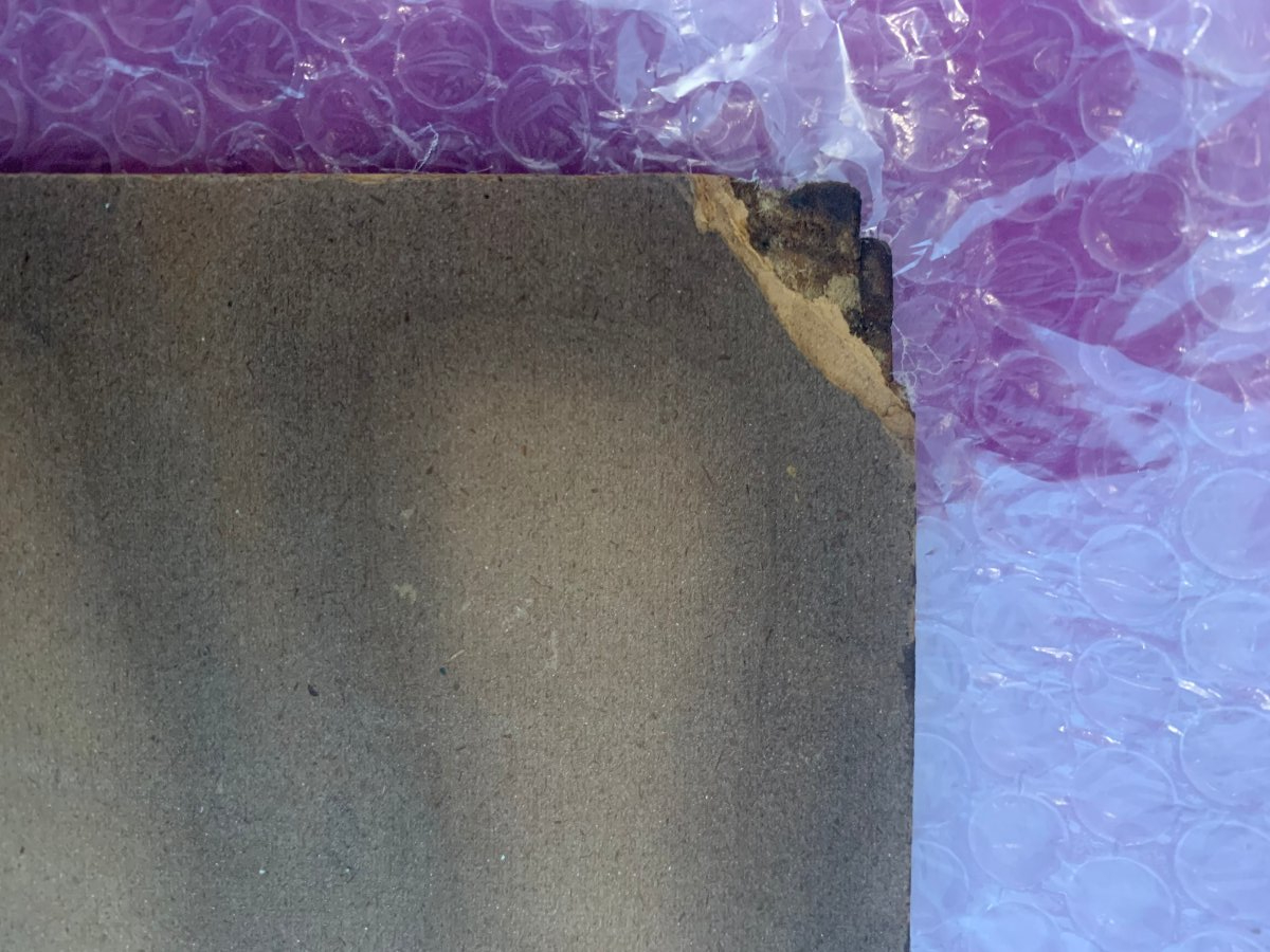

I have also attached an image of some of the corners from behind to show the condition, would those corners work in platform mounting?

Re: 1765 paintings on board and paper
Looking at the new photos, that looks like MDF, hardboard, or cardboard to me, so I don't think it looks a lot like it is genuinely from 1765 at all.
