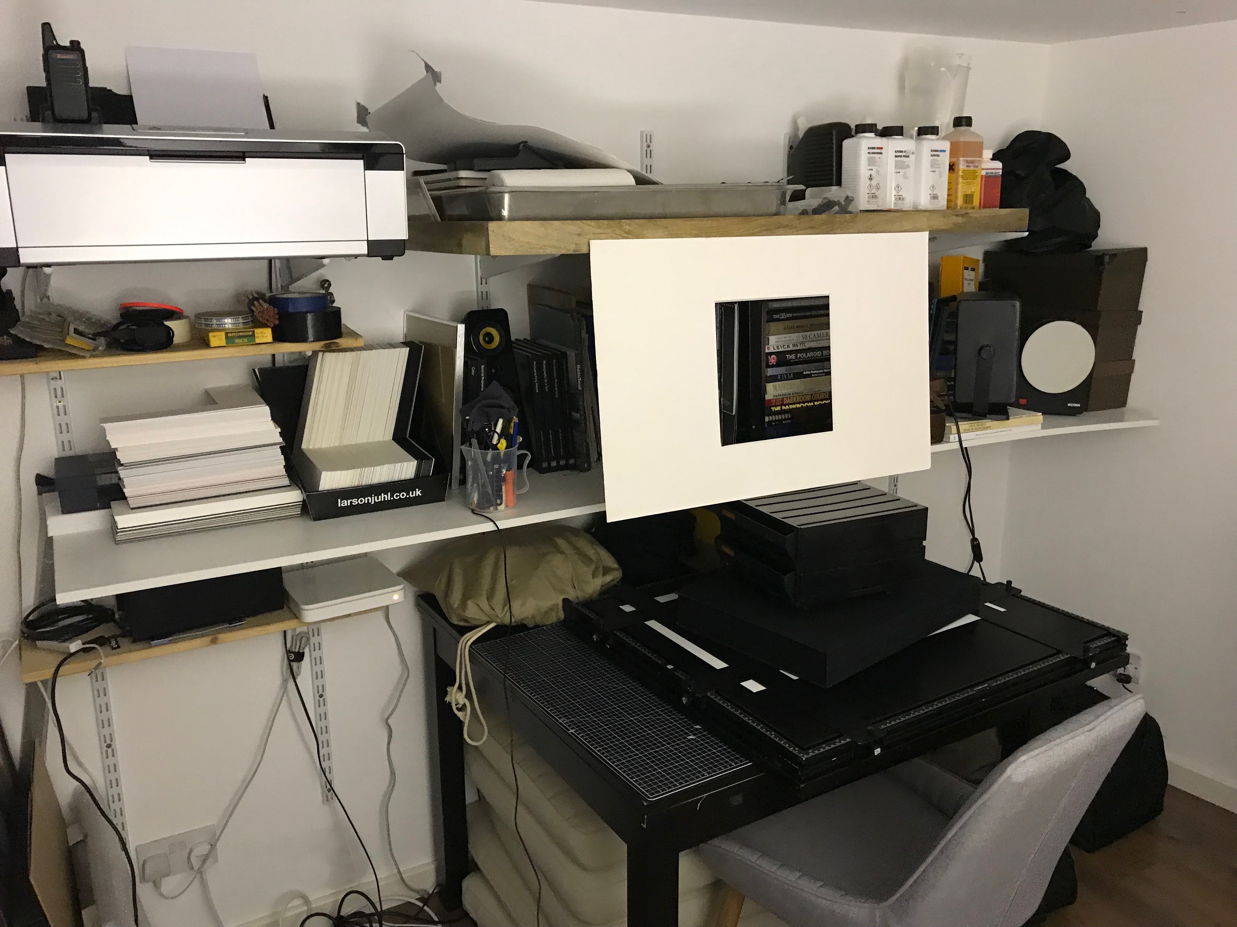

My work-space is small, 3mx3m and its primary roll is as a darkroom.
I'm not a framer, more a photographer wanting to frame my work.
The vast majority of work will be printed on 16x20 and maybe 20x24 inch paper (with images sizes of 14.5 inch x 21.5inch and 13inch x 19.5inch) .
So I will need to procure mats for these sized prints. (I like large boarders though)
I have a rotatrim T650 (shown in a photo) that can cut down boards, its maximum cut length is 800mm (...is this big enough for full size uncut mat boards)?
The mat cutter will have to be stored when not in use and my thoughts was the 40inch version would be better in the space I have.
Do you think it would be versatile or the framing I wish to do?
...thanks in advance.
Jamie

Re: Wanted 1m Version Mat cutter
Are you sure that your Rotatrim T650 cuts up to 800mm and not 650mm??
My standard mountboard from Larson Juhl is 815mmx1120mm as is Daler mountboard.
Moving a mountboard cutter each time you use it will require time as you will have to check the calibration/squareness each time it is re setup.
I have seen them mounted on the wall and used vertically, with a suitable wooden frame constructed to hold it in place, if wall space is an option?
My advice would be to find a large framers who have a CMC, you can supply the mountboard and they will cut the mounts for you at a cost which when you take into account materials, your labour and wastage won't work out much more expensive.
It shouldn't be underestimated how much wastage is involved in learning how to use this cutter and I admit, the mistakes that occur on a regular basis.
If you're short on space, imagine storing a pack or two of standard mountboard, that must be kept in pristine condition, then imagine storing the fallouts for future use on smaller pieces, the offcuts used for slips under the mount when cutting and dealing with all of the scrap offcuts/wastage, oh and a little space to store the tool kit, blades and cleaning product.
A: Pic attached
A: good to know and also a little annoying, Ill look online to see if I can find them at 800mm
A: good to know. I will factor that in.
A: Wow, interesting i never know that could be done. i will go a google search.
A: im not necessarily doing this to save money, more to be able to be more creative and have 100% control of the whole process.
A: hmm OK, I think a course may be in order, I was in D&J Simons and i know they do a day intro course.
A: for me that sounds like a challenge in Tetris and studio design. I'm not sure what a pack of standard mount board looks like, but I will definitely find out when I am redesigning the other side of my studio. For me the ability to test different size mounts for different photos / make mistakes and keep going until i find a ratio that works for the individual image is why I want to dedicate the space and the cost.
Sounds like I'm outvoted on the mount cutter on the wall idea...
https://www.theframersforum.com/viewtop ... 69&p=71909
I only asked because the Rotatrim T650 is 650mm and the T950 is 950mm!

OK - yup the T650 appears to be so named according to its cut length. (Contrary to my measuring tape)
Sooooo, I will need to use the straight cut on the Keencut or equivalent.
It seems though the 40inch will still be able to make the initial cut of the board?

Yes that makes sense.
Like I said, Peter at Framers Equipment in Northampton would be worth speaking to.

I can sympathise with your lack of space, as I have a very small shop as well. To be able to operate in such small premises , I have no choice, but to use the front of my shop as also my workshop area and have my Morso, mountcutter, System 4000 wallmounted board / glass cutter and underpinner all in the main shop area. I would readily admit that it's not ideal, but my customers accept things as they are and nobody says anything about it.
If this works for me, maybe you could consider something similar. Like I said, it not ideal, but it might not be as bad as you may be thinking.

hi
I wasn't thinking of selling it but I may consider selling my Keencut 40" Arrow. See pictures attached.
You will notice I have attached two eyes to the top and it hangs against the wall when I am not using it, (something you may want to consider if you buy one from someone else). I actually also have a Keencut ultimat and I find the Arrow produces better results and is easier to use.
I am London Based, if you want to have a look PM me.
