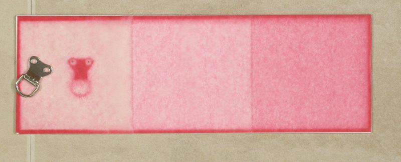

This is the current state of my on-going UV glass experiment. It shows the result of exposure to four and a half years in our north east facing shop window.
Left panel - no glass
Centre panel - normal 2mm float
Right panel - Tru Vue Conservation Clear
For the first year or so the experiment was photographed monthly.

Wow!! Great experiment John
Interesting stuff
Interesting stuff

Hi John
we have conducted similar experiments and noticed a clear difference after only 6 weeks in a south facing window, knowing what I know now, I want to restart the test with the addition of a alpha mat under mount and alpha mat under mount with uv glass, we stock all types of uv glass so ganna try them all.

It would be very interesting to see results using the various glass/acrylic options.
Also, I'd like to experiment some time with the possibility of further accelerating the effect using a strobe light fired at point-blank range.

I assume that the test was done with red mountboard. Therefore I think it would be interesting to have a comparison between standard cream core, white core, conservation and museum mountboard types to see if any perform better than others.
Of course, the other test would be to try this with a fine art print, a colour photo, a water colour, and an oil painting to see how U.V. glass compares with standard glass protecting different art media types. I don't know what it would tell us, but I think that the results would be quite informative.
BTW, was this experiment conducted in the shop window, which is part of your shop front, where customers can see it?

Yes the experiment has been in the window the entire time.

The experiment only ever had one (very limited) purpose for me. To determine if so called uv glass really had any significant effect.
It clearly has.
I thought that other framers might find the experiment of some interest.
What is all the fuss about?
It clearly has.

I'm just wondering if the same test in good to ideal conditions would prove you don't need no stinkin' UV glass and that's why it hasn't been done!
Or maybe, in the case of 'good' conditions 92% (reflective) versus 98% (absorptive) would show no difference.
etc - but what we definitely know is that bad conditions fade stuff whatever.

I use the experiment as a deal clincher, it lets customers see with their own eyes how uv glass slows the fading process, without resorting to explanations or getting into science of it.
