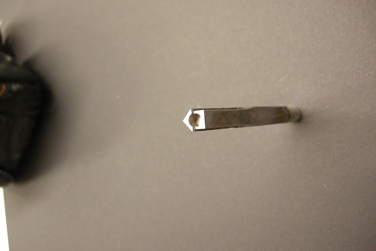

I've been told my Euro is BLR* and I should be looking at a Cassese; that was from my Nielsen rep who sold me the Euro 15 years ago when he worked for Euro Mouldings and I'll bear your experience in mind when it comes to replacement time, which will be, if I cannot get someone to reproduce the hammer, soon!
Trouble is though, I'm set up for bench top, not freestanding and I don't think Cassese do a bench top. I could adapt but I'd rather not.
*BLR is a military term, "Beyond Local Repair" .... written off.

Any luck with the Euro hammer yet Robo?
Re: Praise for Simons and Cassese
Post by Roboframer »
Oh yes!
A member here from France put me in touch with an engineer-type from Windsor ..... !!
He ground and re-shaaped the hardened tip and then added a fraction to the bottom to bring it back to the exact length. That was a spare that was bad but better than the one I had in use, which I have now sent off to him. He retires next month so I was just in time! These two hammers should see me out - well as a framer anyway!
Hammer euro 001.JPG (216.7 KiB) Viewed 3672 times
