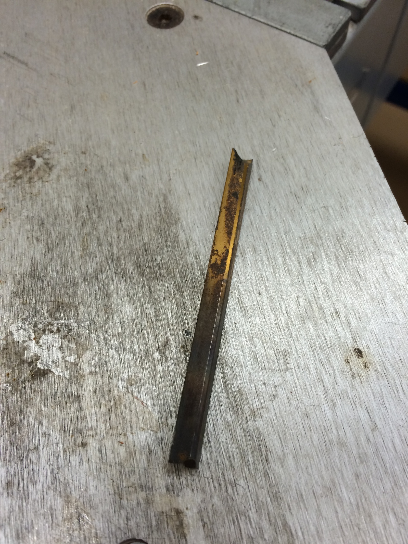

I've got a problem with my Taurus 2KF underpinner. The metal parts that pushes V nail into the moulding cracked and now when you release your foot it doesn't return to its original position.

- IMG_5492.JPG (539.54 KiB) Viewed 6780 times
- IMG_5489.JPG (1.5 MiB) Viewed 6780 times
- IMG_5488.JPG (1.23 MiB) Viewed 6780 times

looks like you have a v nail stuck in there on the last picture

Yes, that happened a few times. It is removed now but the metal bar is broken in half the there is no connection between the pedal and the hummer

I have a Barlow v-nailer, the owner retired and the machine is now an orphan.
I made a replacement push rod after looking at the old one. The original was made from 1/4" x 1/4" square rod. The old push rod was held in place with a set screw. I cut a new piece of square rod to length, squaring the working face and placed it into the top of the pneumatic cylinder where the old one was located - tightening the set screw.
IT WORKS.
I would also clean your machine of glue for better working. Your machine might use 6mm x 6mm vs 1/4" x 1/4" square rod. Measure twice and cut once.

JFeig wrote:I have a Barlow v-nailer, the owner retired and the machine is now an orphan.
IT WORKS.
Hi, that sounds great.
I've attached a picture of it. It definitely looks like a square rod. Do you know where can I find it? It is not a problem to drill a whole in it for a screw, but how would I remove the of the metal (working face)? Or will be just flat square?
Maybe there is some compatible drivers for different underpinners?
- IMG_5681.JPG (954.51 KiB) Viewed 6571 times

This one is about 84mm long.
