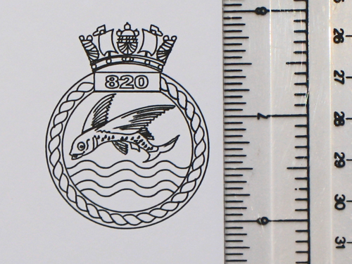

Re: Limits of CNC Mount Cutting/Etching/Bevel etc
Hi Seb
The main limiting factors are you can't do fine detail or tight curves and the cost in time and mount board. The Navy motif has too much detail with the crown, leaves and rope, unless you are doing it 5-600mm wide, or you are going to simplify it a great deal to a simple crown outline. You can do fine detail with debossing and pen tool but this can cause further problems if your tolerances are tight. Personally I don't think it is a design that lends itself to being cut from board, I'd be looking to mount an actual badge if I wanted to include it on a mount design or do it with the pen tool as a drawing. I do some fine detail by hand but you don't want to be doing too much of that.
The other factor is the time, I use a Gunnar and you can create a design relatively quickly, getting the machine to cut it cleanly is another matter, it can take time fine tuning the design, machine settings and test cuts. The more complex the design with different angles and curves the longer it takes.
I've looked at a lot of military badges and the majority are not suitable.
David.
David.
Using Pen Tool on Valiani
John GCF
