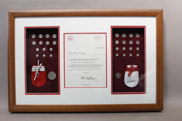

I have a set of Maundy Money coins to frame.
Any ideas how to encapsulate the coins so the air does not get to them? I am making the assumption sealed in a frame in not airtight enough to stop tarnishing?
Ideally don't want to cut a separate apertures in a mount for each coin. Purses they came in going in frame along with a letter.

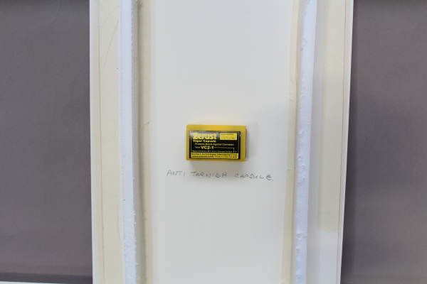

Re: Silver sterling coins
Thank you Roboframer (what is your proper name??) and Mark. Am thinking using enclosure method and capsule will do the job.
Done!
Nicely done!
