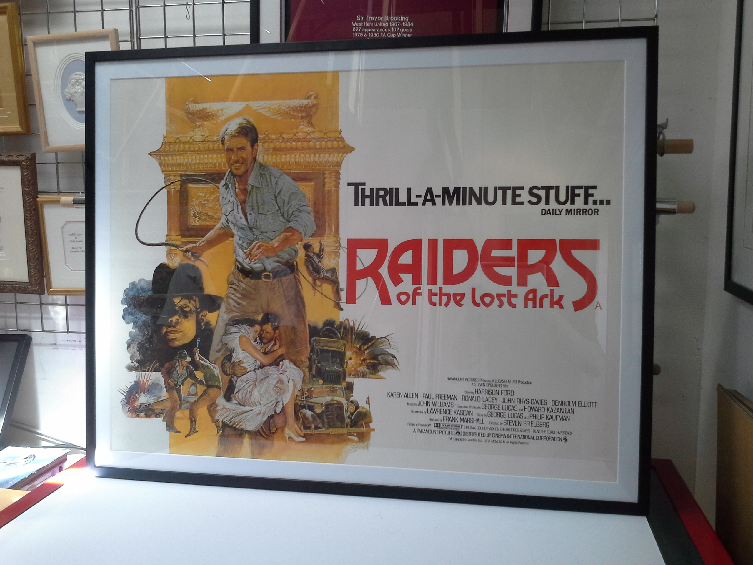

All good stuff, well here's a photo of the finished product, I actually used Neschen Filmoplast T Cloth Tape ( LION ) to attach to the Linen backing to the foamcore board, as I said, I did have to cut the mount in 2 sections as I can't cut Jumbo board but under glass you can't really notice it, I pointed it out to the customer and he was quite relaxed about it.
Thanks again for your input on this , have a good weekend

Nice to see you covered the fabric, but now you have, how will anyone ever know it's a poster??
I personally did that poster like that, and this is why.
1. That is what the customer wanted - and that's about it really.
It was however an informed choice, all he stipulated was a white frame and I'm sure many framers would have thought "what a relief, it's quite large" and slapped it against the glass. If I was framing it for myself or for sale in the shop I would do it the same but different IOW same balance, different colours.
However .................!
"I like float mounting (or if it has been backed to linen, just the linen border showing) as it emphasises that it is a poster"
I do not like float mounting unless the item is of little value and/or the paper edge has interest and/or the image/a signature/whatever goes right to the paper edge. This is obviously a poster, floating it would make it no more obvious - well it is effectively floated, the edges are showing. Linen backing is functional and not required to emphasise it's a poster. If something like this came in its original condition (not linen backed) I would mount just over the edge of the paper as normal, unless requested (and they'd have to insist) otherwise.
There is no "right way" to frame anything
"For me, almost every time, I'll use a black frame"
I hate black frames on pretty much anything (and white ones come to that)
"And it will be a hand-painted frame, again giving a softer feel than a factory moulding"
Black paint is black paint and it can be applied by you, me a factory worker (yes, some factory stuff is hand finished) or a robot and it'll still be black paint. Put that close to this and that's the sort of stuff I get in to re-frame as it looks so bad.
"a frame that big needs AR glass"
Something this nice (I think it's nice anyway) not to mention expensive and having a lot spent on it to restore it (there was a LOT more done that sticking it to fabric) needs protection and it has the maximum for glass in Conservation Clear - I quoted for museum and the guy nearly had a scrotum attack. I also quoted for another white frame he liked better- same size and profile but lacquered and slightly dimpled, from Nielsen's "Matrix" range - and that almost gave him a scrotum attack too - this is Simons Econ 9.
I think it looks fine even if it would not be my choice, I have done absolutely nothing to it and given it the highest UV protection possible for (single layer) glass.
Your method, well, no-one seems to agree with it - it's unnecessary (floating, box frame, spacing) ineffective and possibly damaging (Self adhesive tape and plenty of it) offers little UV protection and doesn't look too clever.
Still, it's good to have different opinion, would be a boring old world if we all did things the same way,
Tell you what, next time you get one, or if you have one even, post a pic and we'll have a poll - not just you, anyone and not just a poll here, ask our customers.
