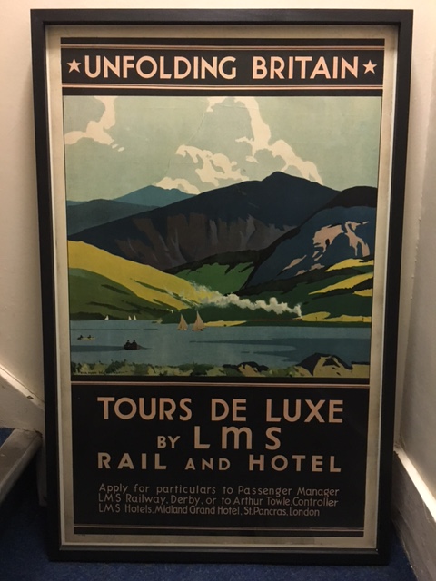

Even on a frame that's 40"x25"? I'm afraid that I just stick it (R&H F2 is the fillet - and I had to use A42 as it was all I had, would have preferred something smaller). If you don't stick it, then it *will* bow. Incumbent upon the customer not to break the glass. And if the fillet is stuck then the glass is less likely to break anyway.prospero wrote:I would mitre and pin the spacers
Here's one I did yesterday. Roboframer wouldn't like it one bit as it hasn't got a huge ugly mount, but he's not able to give me a broadside for it...
