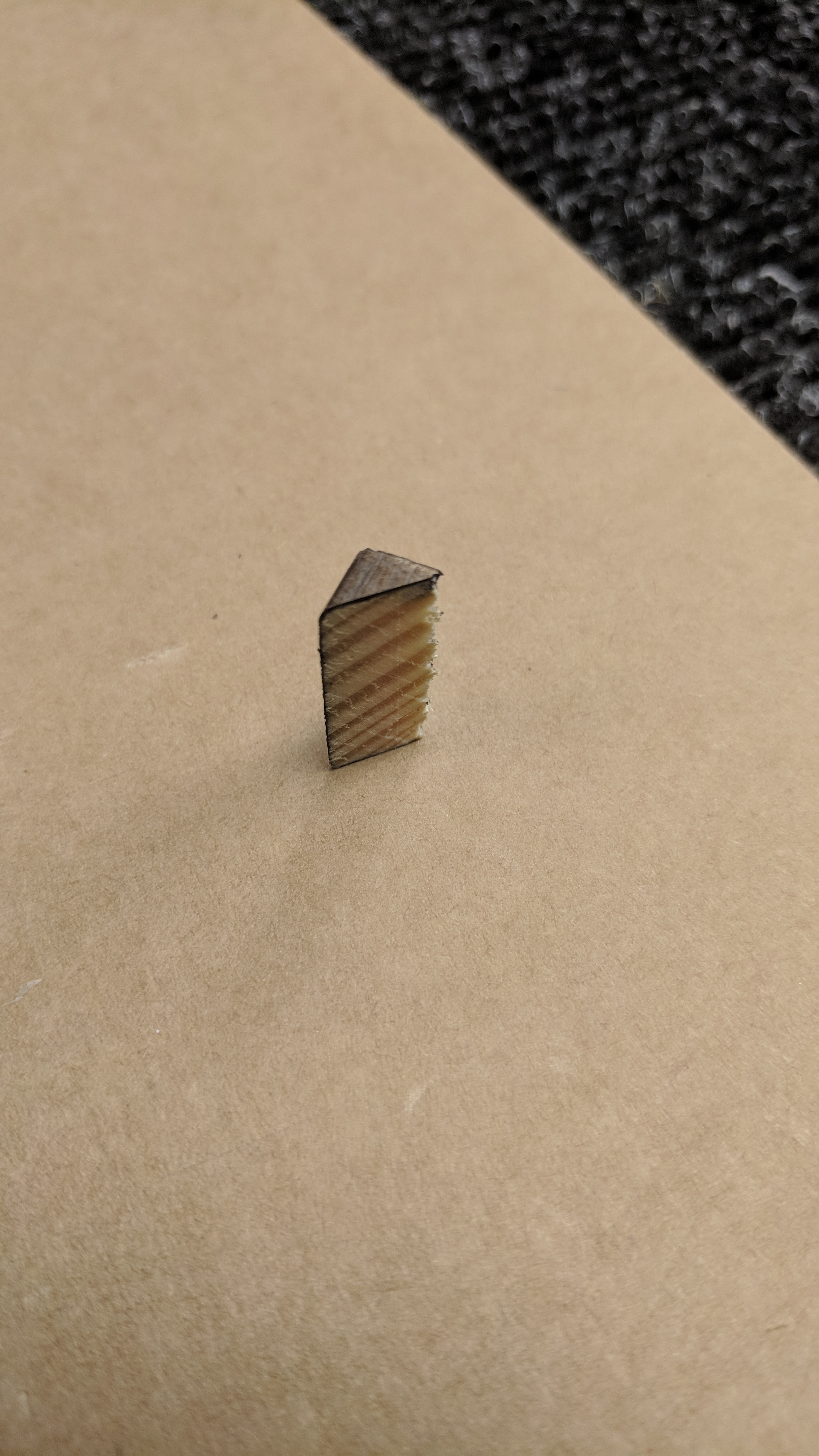

Courtesy of Optimalonand making a whole series of frames from an identical moulding I managed six lengths of moulding with overall about as much waste in the OP. Was it worth the effort in putting the data into the system? Possibly not.
