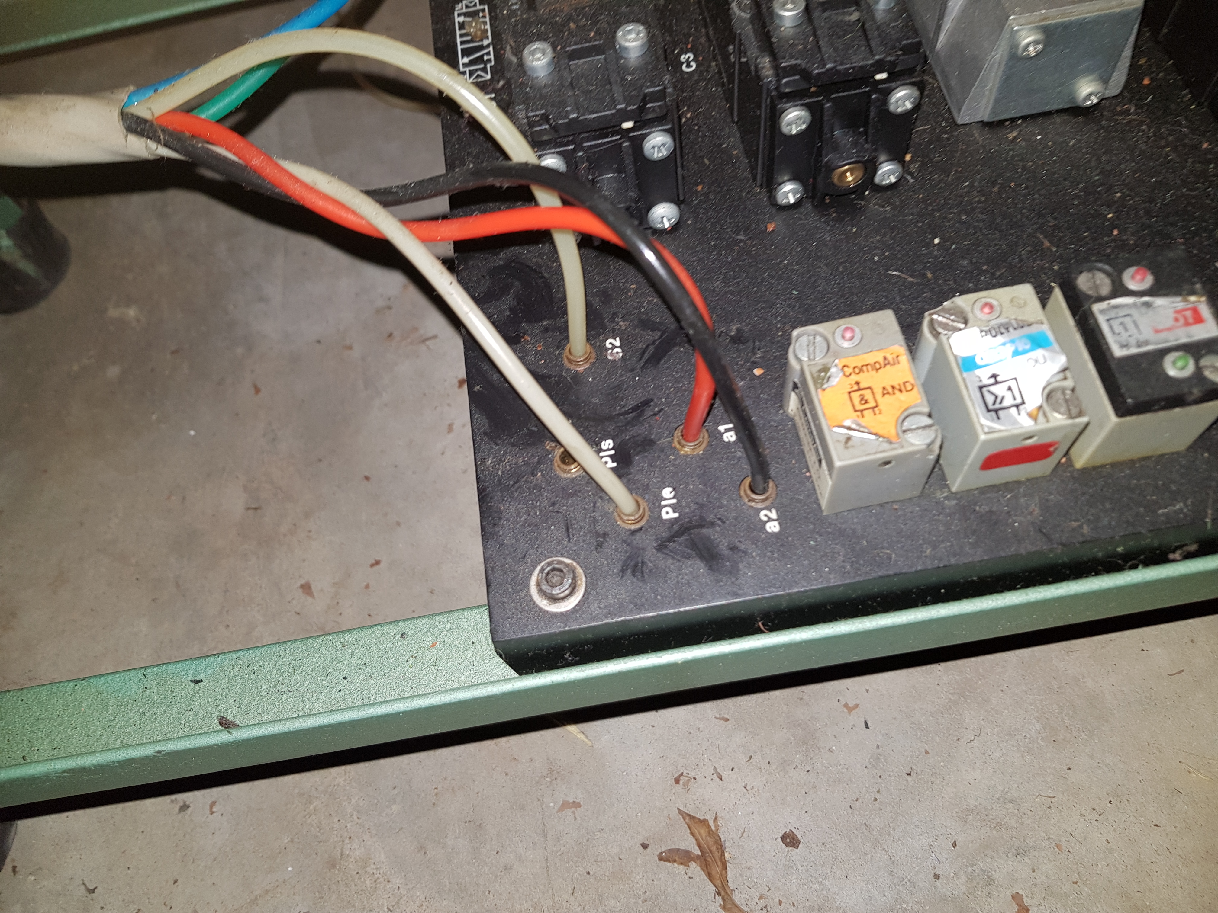

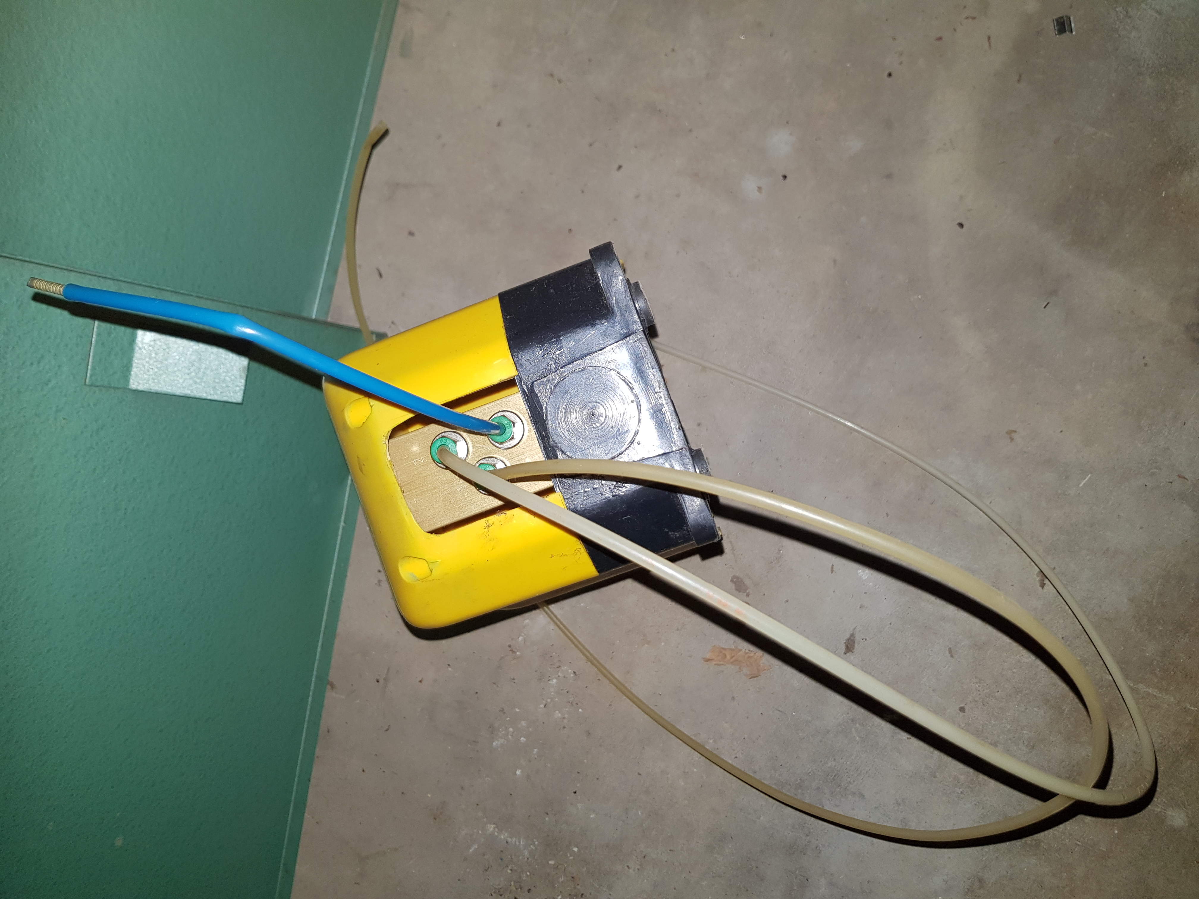

I just purchased a Cassese CS276D. I got a schematic and a not so helpful manual. I connected it to a compressor and there was air coming put of the outlet labelled S2 or Ple (I can't remember which one). There is a foot pedal that wasn't connected so I'm not sure where the small hoses go to make it gain optimum pressure and operate succeasfully. Oh also I put the little white hose pictured in either S2 or Ple and I can't pull it back out. I'm sure there's a nack to it! Any help would be greatly appreciated! Thanks

Ok so I've connected the pedal (outlet 1 to Ple, outlet 2 to S2) and I have movement!

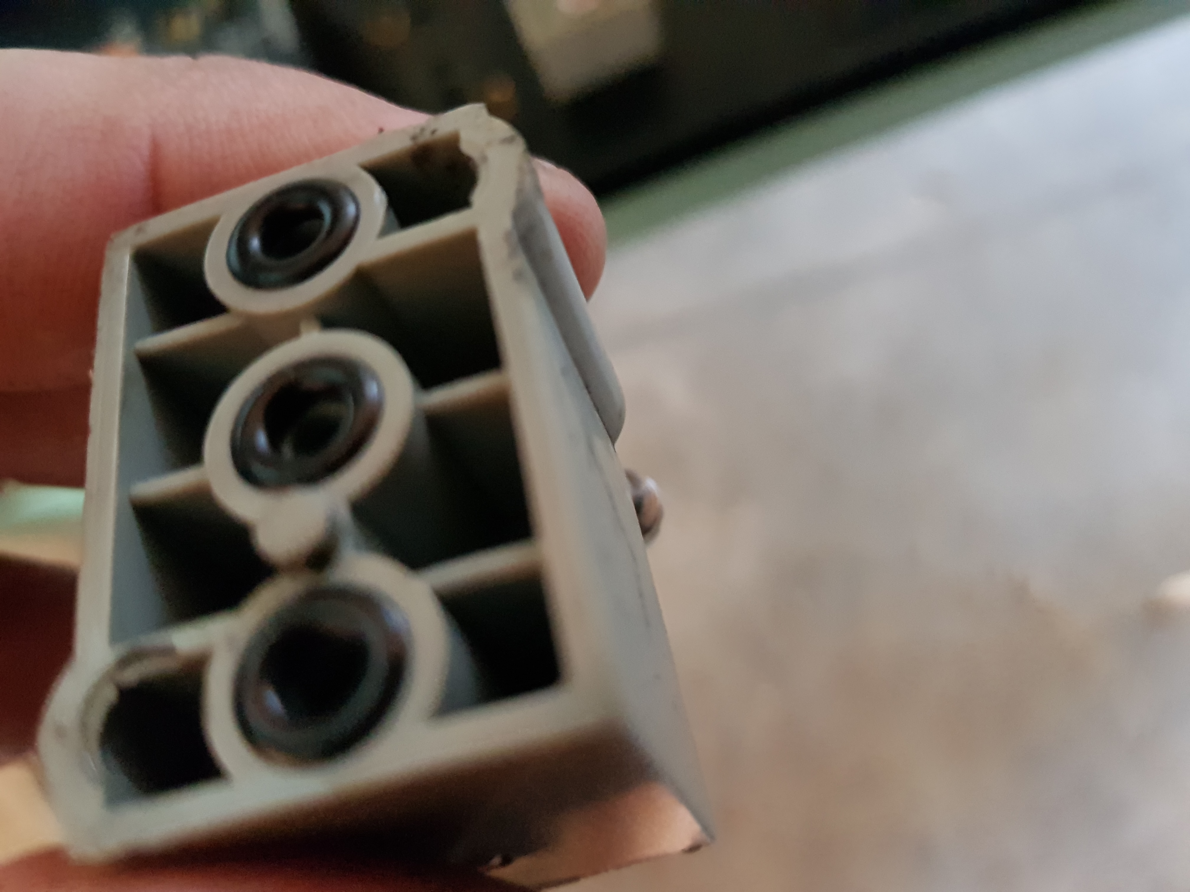

There is a leak at E8 though so wount fully pressurise. Should I replace the grommets? They look ok to me...

As far as I can remember, the most common part that required replacement on these machines were the 'and', 'or', 'not' pneumatic valves, which used to be possible to source through local pneumatics supply companies.

Although your machine is old, the logic valves in your machine are also used in Cassese's more modern machines and it should be possible to source a replacement for the OR valve that you have found to be leaking. I was able to get one fairly recently from a local (UK) supplier. However, before replacing, you should ensure that the fault lies with the valve rather than the seating.
The part number for the OR valve -
Manufacturer: Crouzet
Ref No: 81 521 501
I have been using a 276, bought second hand 14 years ago and have found it to be pretty much indestructible.
Ref No: 81 521 501
