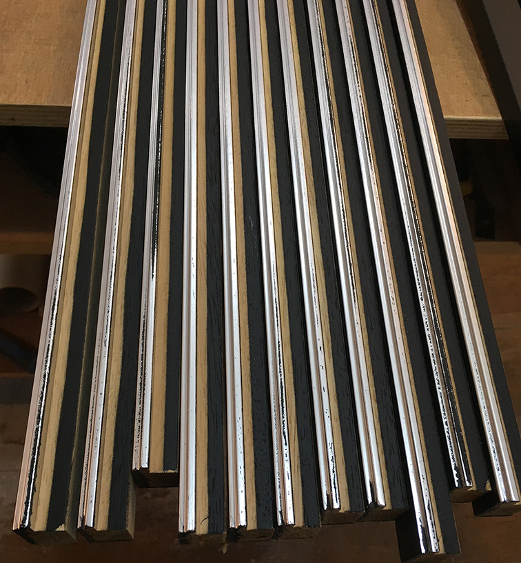

The moulding is a black cosmopolitan with a silver sight edge or in this case a partial silver sight edge.
I unwrapped the other 5 bundles as it turned out so had 16 - 3m lengths of which 11 had paint missing.
Out of those 11, 2 are firewood & if I measure the other 9 from the end of the moulding to where the paint is as it should be, then that adds up to another 4.5m so straight away thats over 10m or £42. But it doesn't end there because most lengths are the same the other end & there are bits in the middle which would also need to be removed so it's unlikely that I would be able to make a decent sized panoramic frame out of 11 lengths of moulding.
How can that be right?
I have hopefully attached a picture although I think it might crop a bit off but you should be able to see the problem quite clearly.
If I come across damage then I will open another wrap so that I can do the job & if the problem persists then I will contact them but for a single length or bits that have to be chopped out of several lengths I gave up reporting because it was just so time consuming but I'm fed up with it.
- cosmo1.jpg (574.76 KiB) Viewed 17879 times
Re: Mouldings defects/damage
That does not look like you were just unlucky, with so many bad lengths, that must be a really bad batch problem. So much for quality control by the manufacturer. All to often the poor old framer is doing the quality control inspection for the manufacturer, which saves the manufacturer having to employ an member of staff to do this.
I'd like to say that this does not happen very much, but I've seen mouldings like this before, so I know that this is not particularly uncommon. I used to regularly buy bundles of discontinued and slightly damaged mouldings and I think that quite a bit of it had been returned from other framers as defective.
I'm not complaining, after all when you pay about 15 pence per foot for a bundle of mouldings and some of the mouldings might be anything up to £3, or £4 per foot list price it's still a good deal, but you get to realize that suppliers can be getting lumbered with quite a bit of mouldings returned by the framer as unsuitable for use. Sorry to disappoint anyone, but the problem is quite common these days and it ain't gonna improve any time soon.

Notyouraverageframer wrote
"Sorry to disappoint anyone, but the problem is quite common these days and it ain't gonna improve any time soon"
It will improve, if we all start reporting and claiming for it, this Monday, I had rep call on me when I was cutting moulding, I showed him some moulding with defects and I tried to cut around them, I couldn't even get a frame out of it, so chucked the lot I the bin and said, "I need a credit for the whole length, not just for the bits of defects as I can't use any of it" I got it as well, he emailed head office and I got the credit not later that day, I also warned him that this is the way it's going to be, I'm going to claim for full lengths, I will put them aside for his company to pick up and I want replacement sent out as I still need the moulding to do the job. It will eventually get fed back down the supply chain, that quality needs to improve

I agree with Steve, we have to report the damage.
I've had issues with the same moulding, it does seem to be prone to the sight edge flaking and I've stopped using it. I find the plain black a much nicer moulding.

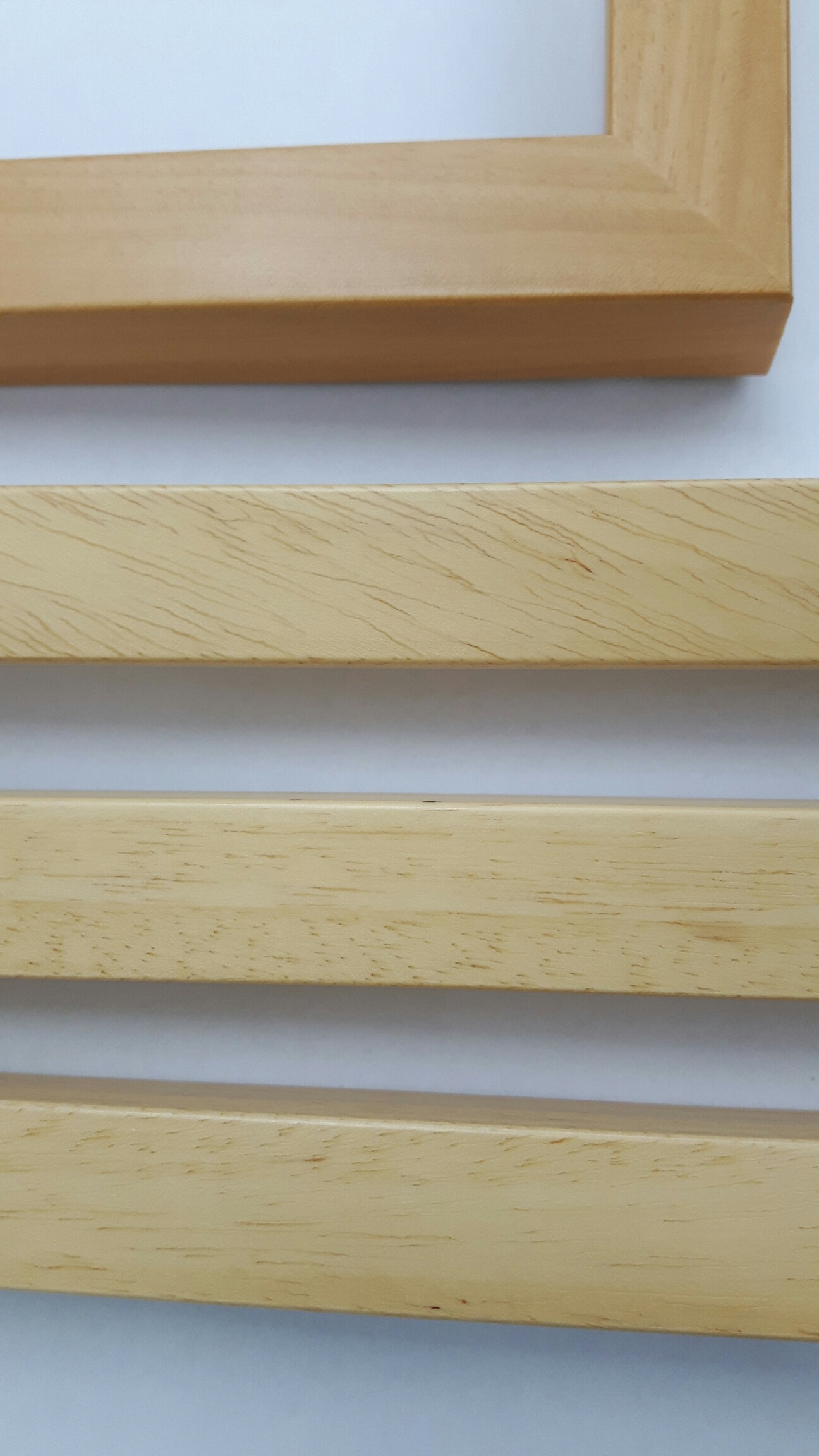

Been reading this with interest....and realised I am not alone.
Shown, sample I asked for only 4 week ago in top of picture. Close match to one of thre of customer's existing frame. Ordered three lengths. Out of stock so ordered in.
Just opened them up and all 3 vary greatly from each other, one has a black mark on it and all are much lighter than the sample.
Now have to see if I can get darker one - will probably need another order - or if customer happy with paler ones which do match the picture but not the existing frame he has of the third. First order from this customer and it does not make a good impression.
Have had many dings/irregularities/variations from this supplier and thought just my bad luck but the more I read the other comments the more I realise it is common. I expect some slight variations in grain and colour when ordering wooden mouldings but this is nearly a whole tone darker. I can only think the sample they gave me is old stock which has darkened over time - is this possible?
My main supplier is local but often still means an extra trip there to sort problematic mouldings.
Tried mail order from Lion a couple of times but got the strapping damaged and one of the mouldings was very warped which I then had to photograph and email to them to prove...
I worked in a packing and despatch department for 16 years. I always always checked consistency and quality and packed securely. Really not that difficult!!!
So have emailed them with photos and asked them to phone me tomorrow to sort.....

Have just checked the specs online and see it is in the sale which usually means that it is being discontinued and probably because quality not good enough and other framers have stopped ordering it!

It's quite common to find variations in colour and tone in bare wood mouldings and stained wood finishes. Some suppliers will try and send you lengths which are reasonable well matched, if you ask, but don't count on the warehouse staff being as discerning as you are expecting them to be. In my experience their idea of matched lengths of wood and yours, or my expectation still are not that great, but it's better than no attempt at matching at all.
If anything, things appear to be getting more difficult with hard woods and bare woods, particularly with pine mouldings. Not everyone likes working with pine mouldings, but if you like stacking mouldings, then you get some quite useful mouldings at quite good prices. Relatively recently, some of my favourites have been discontinued, which kind of spoils my ways of doing things as you need mouldings which fit together well and look the part.
The other consideration with pine is that some mouldings use a selected grade of pine with almost no knots and then others use an unsorted grade of pine and you end up ask for selected lengths with minimum knots and defects. I wonder how many forum members remember those nicely colour washed Albor quarter sawn straight grained pine mouldings that you used to be able to get from Euro Mouldings. Well, I used to hand finish my own copies of these mouldings, but the moulding that I was able to do this with has now been discontinued.
