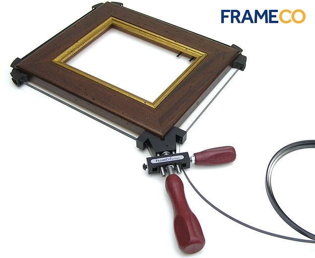

Hi all
Occasionally I have an issue where by deeper rebate mouldings - pinned and glued using wedges - remain slightly open at the face and require taping until glue dries.I am looking for a good clamping system that can hold the mitres together instead.
Anyone use the following? Any good?
Any other suggestions welcome
many thanks

Strap clamps are definitely the way to go but the Frameco seems a bit expensive. I use loads of these -

I use the Frameco clamp. Yes it is a bit expensive, but it has a steel band instead of a strap so doesn't stretch and feels really solid when it's pulling a frame together.

I have axminster ones and they work for me. I only use for exact reason you gave when i have pinned frame but need to pull top tighter and these work well for that.
If i was gluing a frame without pinning, then i would use frameco, but i do always pin, so axminster ones are fine.
This is what works for me anyway.

I agree that the Framco will give a stronger clamp but unless you're trying to create nuclear fusion at the joints, the Axminsters are more than adequate for the job.

I have a second hand frame co, I glue and clamp then underpin while clamped. It's a great tool.

Thanks all for the advice. Will buy one or the other! Probably frameco as it looks more robust but will see.

You'll enjoy having a strap clamp in your workshop, I couldn't do without mine. I've a collection of clamps including a steel one which I find a bit unruly... it seems to have a mind of its own
but you can play a lovely tune on it when tensioned
I favour the Bessey BAN700 and don't have a problem with the strap stretching... but it does play a much lower note when you twang it!

There are the good old framers spring clamps which were widely used before underpinners became available.
They are very effective, but do leave divots which you have to make good. OK if you're hand-finishing.
But on deep mouldings it's often necessary to cross-nail the tops, so you already have a hole to fill.
All-in-all I think the strap clamps are the best solution. Trouble is, if you are doing lots of frames you need lots of clamps
which is not really on.
Only other solution is a dovetail joiner. Worthwhile investment if you are doing deep frames on a regular basis.

I've got one of the cheaper ones with the nylon fabric band as opposed to the expensive one with the steel band. I've no idea if it's the same as the Axminster band clamp, or not, but It is more than adequate for getting the job done. If I am using deep mouldings, I like them to be deep enough to be able to get the band clamp around the frame, but without the band clamp preventing the frame and band clamp from being placed onto the underpinner for joining. For this to work the band clamp needs to clear the fences on the underpinner. Hence the need for deep enough mouldings.
I don't wait for the glue to set, before underpinning, but I don't stack wedges anywhere near the outer edges (or back of the frame), as this can result in gaps in the outside of your mitres. I would add that some of the closer grained hardwoods, such as walnut can be a lot harder to get a nice mitred neat result and can be difficult to predict when a nasty mitre joint will appear and it can be expensive when the last mitre on an expensive frame goes badly wrong with no warning and much of that frame may become waste.

These are quite good https://www.screwfix.com/p/bessey-ban70 ... 0wod8wYMNw

Although I use a Frameco like the one above, I've just ordered one of these as well:
https://www.amazon.co.uk/Stanley-ST0831 ... B001DZVNE8
For the price it's worth a try.
