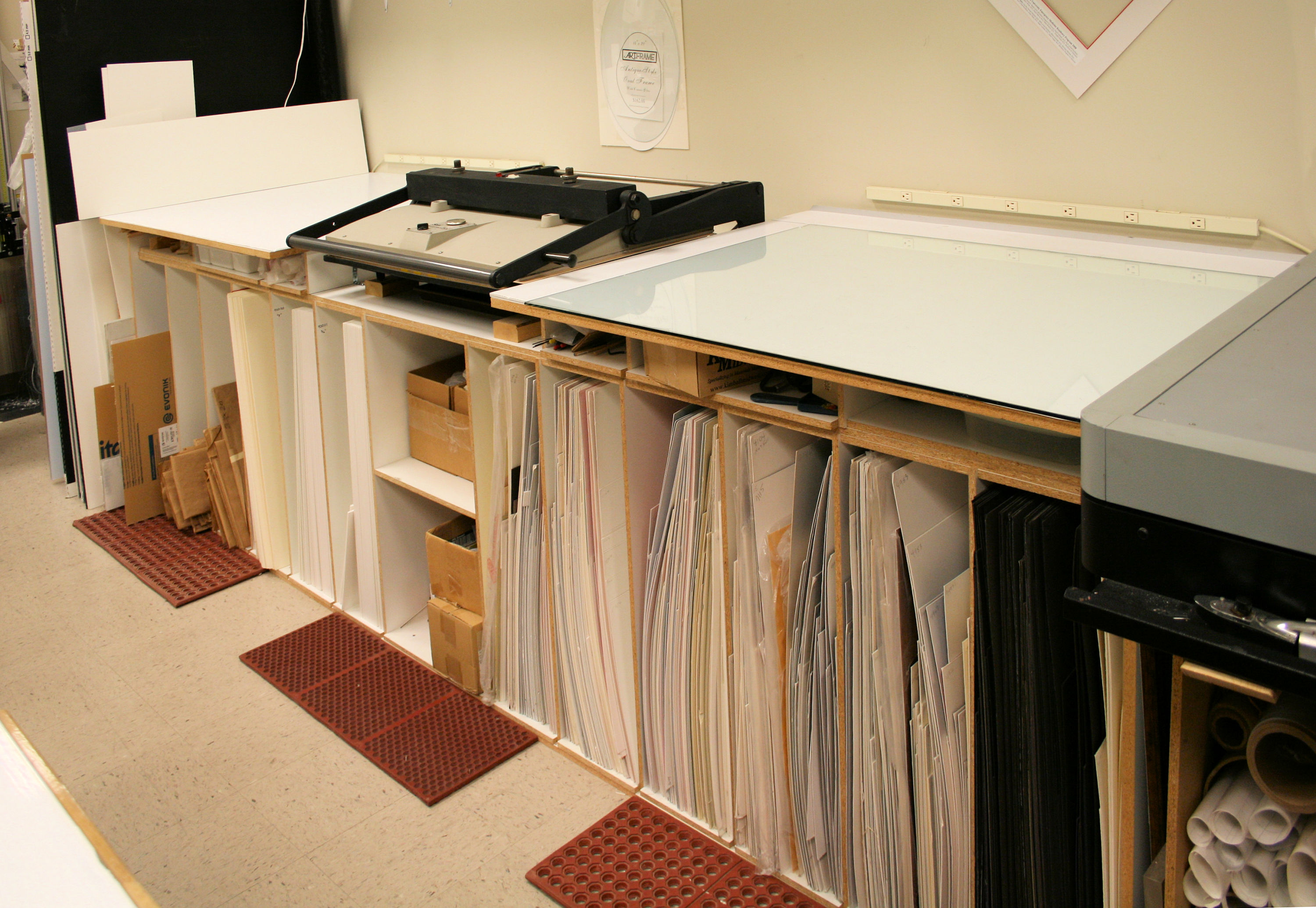

My recommendation would be to build the table out of 1/2" thick melamine-covered particle board, except use 3/4" for the top. You can attach slats to the bottom panel and underside of the top in mirror-image, with grooves to slide the vertical parts in. This table would go together like a puzzle. Be sure to design with perpendicular vertical parts, so that it cannot wobble in any direction, and fasten the structural members together using 1" aluminum angle; cut to 4" and use 1/2" x #6 panhead sheet metal screws.
The pictured table is more than thirty years old and has been disassembled, moved, and reassembled three times, and it is still rock-solid. You can configure the interior for vertical sheet storage, shelves, or any other purpose, but the main point is that wasted space under the table can be totally eliminated.
For height, I suggest that the top be an inch or so below your elbow.
At the WCAF Expo in Las Vegas this week, the new class on "Tables and Fixtures", featuring this table design, was well-attended.
ARTFRAME Mat table-LoRes.jpg (259.64 KiB) Viewed 8003 times
