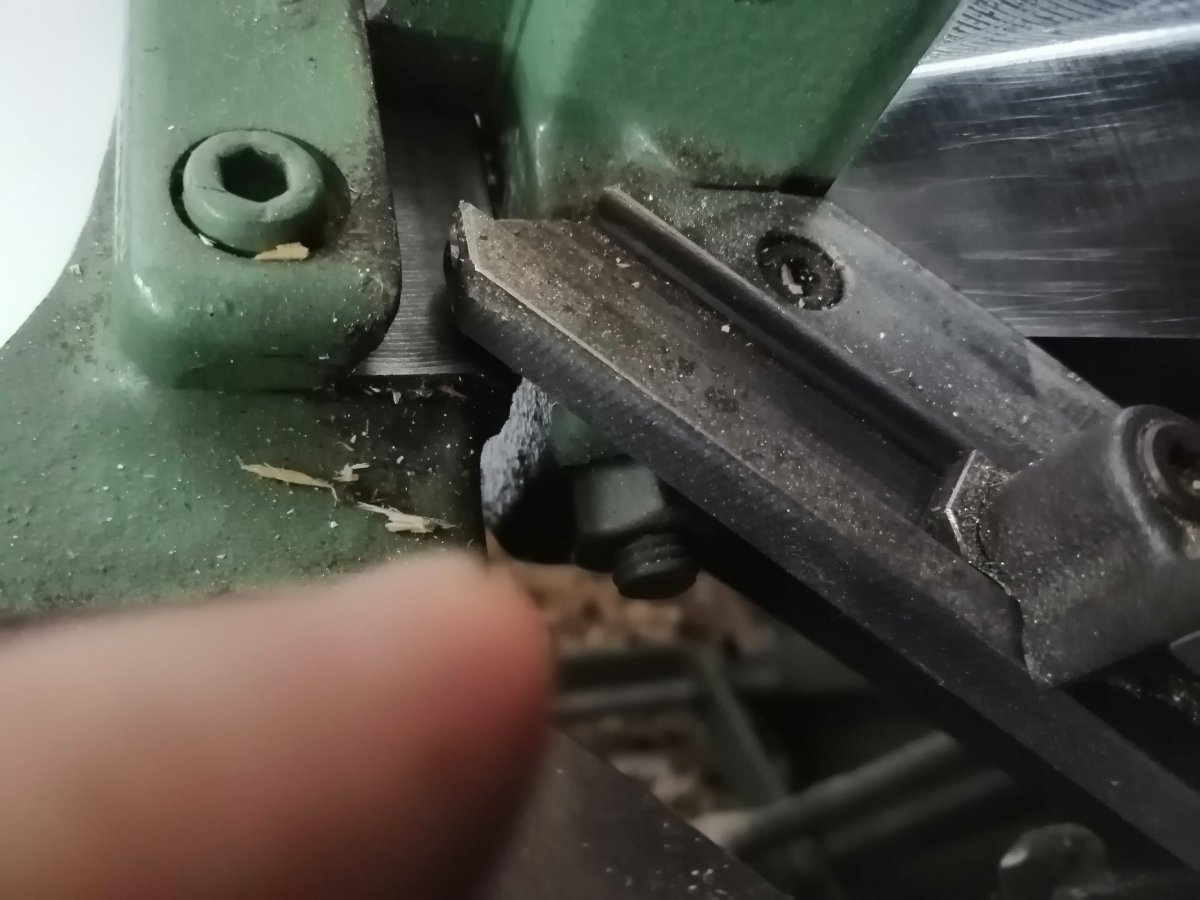

Guys is it these nuts that adjust the head in and out travel?

Guys is it these nuts that controls in and out travel

That's not the right nut at all. The nut is under the quadrant area and it releases an off centre adjustment sleeve. If you don't know the correct way to adjust it your blades will be trying to cut into the cast iron and that might be the end of your blades. Also, trying to snuggle the blades into the gap between the fences might not work, once the blades have cut into the fences. Perhaps, not a good idea!
Why are you so convinced that this needs adjusting. I'm not saying that you are wrong, but isn't there some way of finding out first? People are suggesting that the machine needs adjusting. On what criteria is this judgement made? Lets say you decide to adjust this setting, what's the correct procedure to do this? How do you know if it's a problem with the moulding, or the machine?
