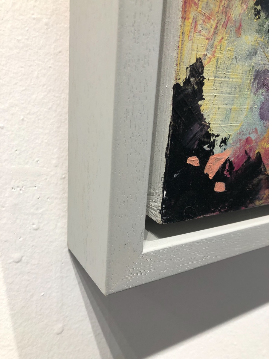

If anyone can help I would be very grateful. :) I’ve been asked to source this frame, it’s a tray frame and measures 3cm wide and 3.5cm deep and was originally a plain wood. I’ve looked on Lion, Rose & Hollis, Wessex and Jarson Juhl but can’t see anything right. It seems to have a small amount of grain visible.

Looks like maybe Lion L1996... maybe not wide enough tho

Hi thanks, yes sadly not wide enough, only 1.2cm and I need 3cm. Pretty much right depth at 3.3 cm.

The grain sounds like Obeche and I'm wondering if they've reversed a moulding and inserted an mdf tray at the base?
Looks like maybe you could cut down a R+H A344?
Re: Does anyone recognise this?
What Justin is saying is a pretty much standard solution. I have not bought a tray moulding for more years that I care to remember. That's probably the same situation here. I find it really helpful to do this. I can nearly always find sometimes in stock that will do the job and with various tools like a bandsaw and table saw, if it's not exactly the size I need, I can often make the adjustment. I often save a bit of money too.

Looks like a standard moulding with a base added, you can see th erebate in one of the photos.

It could be something like this with a base board fixed into the second rebate: https://mainlinemouldings.com/index.php ... D=010-7100

I realise I stupidly have attached the wrong photos ! :head: :head: !! Sorry!
These are the right ones. Thanks so much for all help so far ! It’s definitely a tray frame I’m after - as the artist told me that was the case ....?

Looks a bit like Lions 30mm tray. L1883 or possible L1877

The best suggestion I can come up with is Rose & Hollis A115 turned on to it's side, so that the sight edge is protruding at the rear of the frame and that a suitable fillet, spacer, or MDF section is fitted into the rebate to form the back of the tray. The width of the rebate on this moulding is of the order of 10mm and anyone who actually wants to and has a suitable workshop saw can easily trim another piece of obeche moulding to that size to make a nice flush result at the rear of the frame, if that is considered important.

Thanks very much for all the help and wisdom! Geospectrum I think you’ve cracked it, it looks like Lion L1883. Will ask for a sample to show. So pleased to have found it! :D :D
