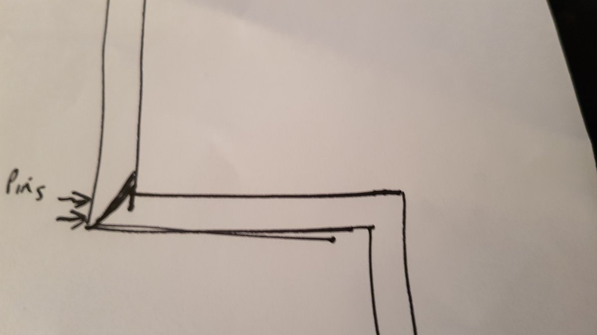

I would nail the corner and glue. There are lots of joints you could do like a mortice and tenon or a half lap, or use a dowel or biscuit, but the nails will be positioned on the inside of the frame under the rebate so as long as you get them flush, you don't need to fill etc.
Just did quick scribble to show where i mean
All glues will hold it, i prefer titebond 2, but any decent glue will hold it tight. A mitre clamp will help if you have one.
Like i said, lots of options, but when possible, i think keeping it simple is easier
