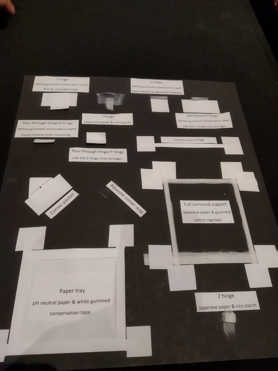

Jon Price (GCF) did a hinging demo last year in Stratford. He showed a technique where you use lengths of your preferred tape folded in half at the top, bottom and sides which are secured at the corners, out of sight under the mount. Hard to explain, I'll post a pic if I can find it.
