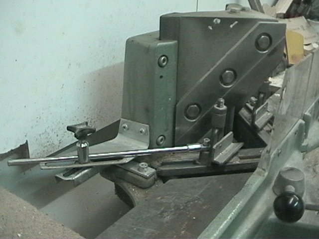

Posts: 11673
I used to have the same problem until I fitted this....
Moglet
Posts: 3485
Location: The Shire
Organisation: An Urban Myth
Post by Moglet »
OK - Eejit-features here needs some help. :oops:
Howz it work?
........Áine JGF SGF FTB
Posts: 11673
Clever init? 8)
As the cutting block moves in and out the rebate support always stays the same distance from the fences. There is one each side.
It's a while since I fitted it, but I assume it's an official Morso accessory.
Moglet
Posts: 3485
Location: The Shire
Post by Moglet »
prospero wrote: I assume it's an official Morso accessory.
Just checked, and the screw holes are there in readiness.... :?

Posts: 11673
:) I had to drill mine. :?
