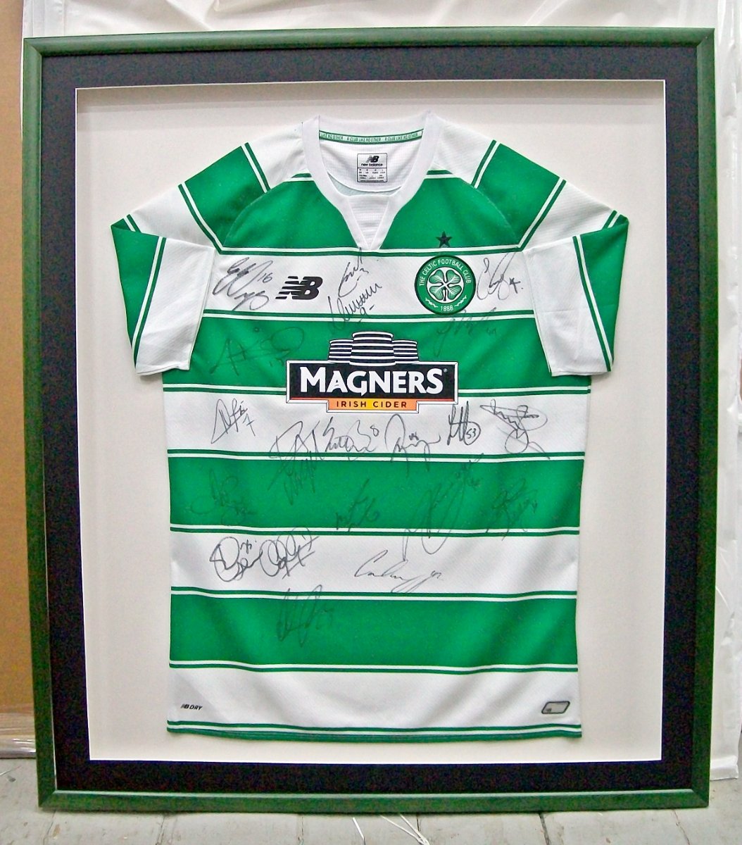

Re: Football shirts
I go for a loose finish with some folds showing - its fabric and should reflect that to my mind. If it is going to be displayed absolutely flat and stretched you might as well just photograph it and frame that. I only do it like that by specific request and the almost total preferment of my customers is for the more natural look.

Re: Football shirts
Thank you, it looks great. Did you pin it, tag gun it or sew it to the board? Can I also ask how you got the 3d look? Thanks
