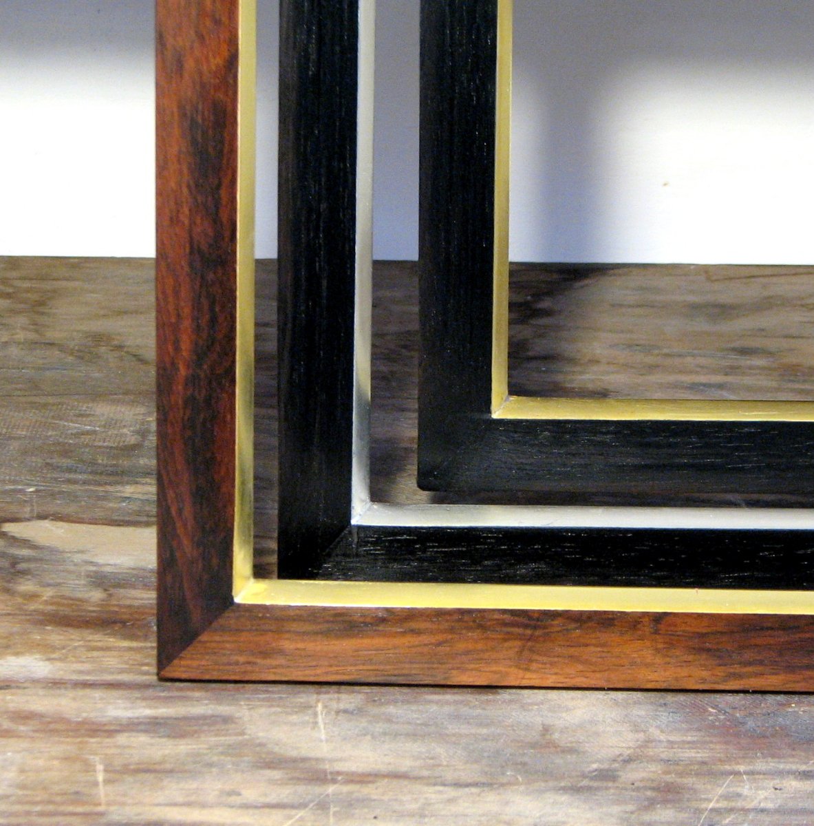

Working on some new mouldings and finishes
- Posts: 1590
This is where I got to so far -
I've painted on an ebonising shellac finish on two of the samples, and a traditional wood finish effect on the third.
To sum all this up so far, I started with a bog standard A40 obeche moulding.
Stuck a rosewood veneer on top. Sanded it down with a hand sander.
Cut a steep bevel into the front - (run it through an angled table saw)
Painted gesso onto the bevel and applied gold and silver leaf. No need to mask it out - just sand away the excess from the top.
Then two layers of black shellac and a wood finish on one other.
The next stage will be to give the shellac finishes a bit more character and then work on the gilding to create some 'attitude'.

Thanks for the praise Mark.
If you buy rabbit skin glue from what I would call a third party source, ( ie. general wholesale framing supplies ) then you would be buying a low grade and quite rough source of glue. As you say, this will be quite strong smelling and pretty coarse for any fine work such as gilding.
If anyone does fancy giving traditional gesso a go, make sure to buy the refined grades from a specialized gilding supplier.

Great work Dermot. I love the wood finish one.
I've bought RSG from a a framing supplier and found it to terrible to work with. I bought some of better quality on Dermot's recommendation and it's like night and day, much much better to work with. I actually quite like the smell of it, Mark.
Matt
Matt

Re: Working on some new mouldings and finishes
Hi Mark
I buy my veneers from Capital Crispin in London. They are quite 'old school' in their history and choice of decorative veneers. Whilst I use a vacuum press and Titebond glue, you can just use some sheets of iron on adhesive to attach the veneers. Ebay is a cheap on-off source. And I notice that Vale veneers sell some pre-glued veneers that you can cut out and attach using a domestic iron.
The whole idea is to hide the really boring obeche wood grain and replace it with a much more attractive grain pattern, and this is what shows beneath the top painted finish, black, white or whatever.
Cutting your own veneers using a bandsaw is technically possible but would require extra effort in sanding down to a fine enough finish. And unless you had a board of fine mahogany, walnut or rosewood - I'm not sure why would you do that.
