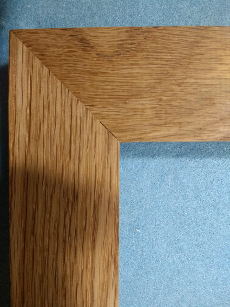

I'm having a problem with cutting (mainly Oak) frames. I've had the blades sharpened and checked for damage and they are apparently ok. For some reason there is a small chunk of wood taken out of the left hand mitre cut. Does anyone know what might be causing this? I attach a photo.

This normally happens to me if the rebate support isn't set exactly to the right height. If there's a slight gap then the wood can bend down with the pressure as it's being cut and end up uneven. It helps to take a tiny slither off on the last cut too.
Re: Uneven cut on Morso
Is the wood trying to move slightly to one side at some point during the cut. This can sometimes be a bit of a problem, when the Morso is trying to take the line of least resistance. The way to check this is to clamp the oak moulding to the bed of the machine and to see if this stops the problem from occurring . The big clue here is the fact that you are saying that this is happening with oak and this is so much harder than most offer types of wood.
Is this happening on the right hand side, or the left hand side? There is a bit of a difference in what may be the solution to correcting this problem depending on which side this is occurring. I have added an extra morso spare clamp to the short rule on the right hand side, because the short rule pulls away from the long rule pulls away from long rule, when the oak moulding pushes really hard against the short rule during cutting.
To be honest, looking at the photo, I am more likely to think that the sight edge is moving downwards during the cut due to a little bit too much movement between the sight edge and the rebate support. Adjusting the height of the rebate support, is sometimes only a partial fix, because the's more of a gap between the blades and the rebate support than is completely neccesary. The is a little bit of a design weakness on all Morso and not always completely possible, without resorting to more extreme measures.

Many thanks for the replies. It seems that I need to secure the moulding before cutting and check the rebate supports.

Please may I suggest trying to cut it upside down as it looks like quite a flat piece of oak and see what you think.
