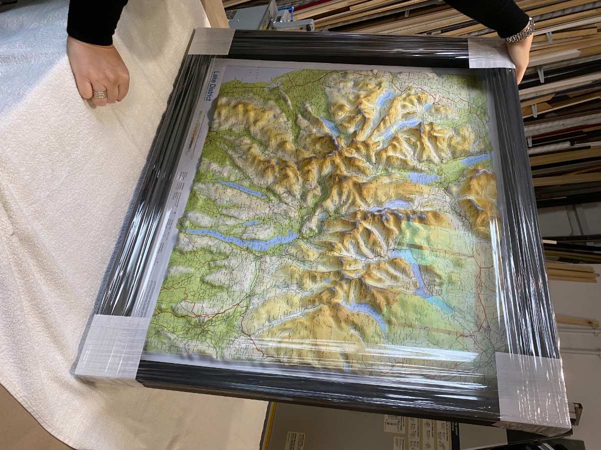

Here’s one we did last year. The moulding was a deep rebate from Lion and I made my own spacers lined with black mountboard. This 3D is made from plastic.
Steve
Chief Coffee Drinker

Re: 3D Map Framing
Steve
Has that got glass in it?
Did you need to stick it down, or was it stable enough to hold with the spacers?

- YPF
- Posts: 463
- Location: Worcester
Re: 3D Map Framing
Jeremy,
Glass - AR70
Not stuck but I did use another flat board behind to give it a bit more stiffness before (the slightly bowed) backing board. Our self made spacers were enough to hold it all in place
Glass - AR70
Steve

- YPF
- Posts: 463
Re: 3D Map Framing
Zac,
No glue, it was quite rigid and was held in place with the spacers.
