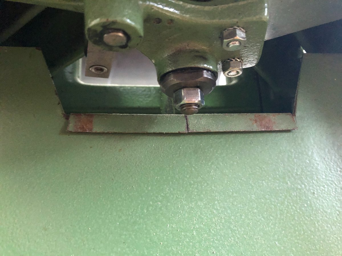

Cutting with my Morso, I can' get a clean cut on the back edge of the moulding without placing a strip of mountboard between the fences and the moulding. without this board the back edge cut is awful!
I have made the adjustment on the Cam (photo) but, even then, when the blades are closest to the fences, it is still bad.
Are there any other adjustments I can make? I don't think new blades would help? It is happening on both sets.
Any help would be much appreciated.

Thanks for the response, I first noticed that I got a better cut years back and have just got into the habit of using the mountboard. It pushes the moulding back towards the blades by 1.5mm and the back edge gets a proper blade through it, rather than just grazing it without it. If I could adjust the blades 1.5mm towards the operator it should cure the problem but don't seem to have any more adjustment on the cam (photo). There is room for the blades to come forward.
The blades are sharp, 3-4 weeks. I bought my morso inside, after being in the garage for 16 years and gave it a good clean and oiling. It still works beautifully apart from the above

Have you tried adjusting the two nuts to the right, which hold the handle tight? I found that I could loosen these two, move the handle a few mms to the left and retighten the nuts. It made the difference.

Problem Solved!
Thanks for the suggestion Justintime, there wasn't enough movement if I loosened the two bolts that hold the handle. I loosened the two nuts/bolts next to the cam nut and pulled the blades towards me, and retightened and all now fine! It my be useful for future reference.
Many thanks everyone for their suggestions
