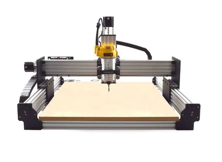

A CNC is just that. A bit like a CMC but for wood and metal.
It can cut mount board if I use the drag knife, but not at a 45 degree angle. It can do many other things as well. I have a laser engraver attachment and I’ve used it for mount decoration but is main strengths are wood and aluminium.
Here is a picture of a small version.
