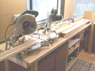

I use a pair of DIY chop saws in a dedicated set up. I use it more than my Morso, mainly for wider mouldings.
Bear in mind though..... I only use it on bare mouldings that are going to be finished after joining. It is (surprisingly?)
accurate, but any minor chips and whiskers and tiny gaps get 'made good' when the frame is finished. I wouldn't really
recommend it for finished moulding.
** Although the saws were quite accuarate straight out of the box, having a pair allows one to be tweaked be slewing it
slightly on the bench. The same principle as the Left Fence Tweak on a Morso. Also you don't have to swing the head and
disturb the angle.
*** The saws are Makita. The pukka Japanese machines. Watch out for Chinese made versions made under license which are
half the price. The whole setup came in at <£500.
I swapped the 24T blades it came with for 80T negative rake.
