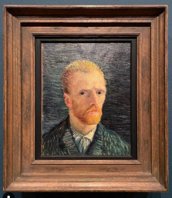

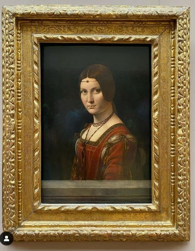

Here's what I mean, Justin.
You could cut out the small surrounding section close to the artwork and still have a frame that could be hung on a wall.
If you were to rearrange the lines on your mount then you could bring that effect into play.

Re: Critiquing a piece of framed work.
Hi Dermot,
I like the top frame, it's very much my sort of thing. I make stacked moulding frames a lot like that myself, but one of the mouldings I use is obeche and the other pine, so I also add a wash as part of the finish to hide the fact the the two wood types don't completely match!

vintage frames wrote: Tue 06 Sep, 2022 11:44 am Here's what I mean, Justin.
Cut the artwork?
I can hear the sirens in the distance as the framing police are coming to arrest you!

Oh dear, oh dear.
Sorry, it has to be my fault.
I did not mean to physically cut anything out!
I meant mask out the surrounding frame visually, so you see only the first 1 inch wide section around the sight edge.
Or does that make any sense yet?
