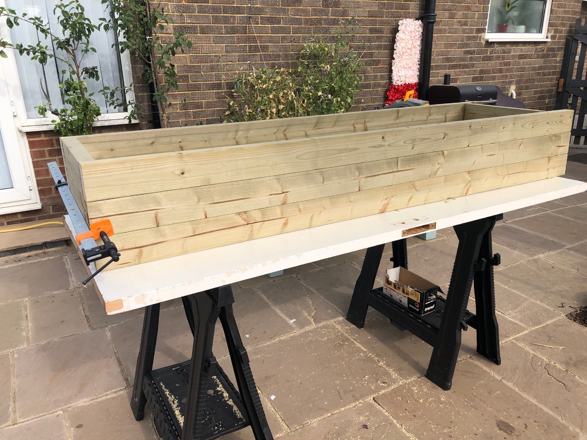

I recently made nine frames not far off this size - which may be “big” but really only in one direction. If it was 3m square or even 3x1.5 m - then you’d be talking.
I then screwed these huge frames together to make three planters.
It would’ve been just as easy, or no less difficult, to make the individual frames flat instead of high, if you know what I mean.
Then you can buy stuff like skirting, In solid oak if you like; make that say 8mm wider than your main frame and glue it on top to create your rebate lip - clamp it while it dries. The joints won’t be mitred (but they could be, you can buy longer than 3m) but straight butt joints look fine - as they do on an oak door with a glass panel, just like my kitchen door!
This was made in my garden, on a saw horse - two inverted V bits of plastic with an old door on top. Some sash clamps and spreader clamps will help and so will a random orbital sander - these things, and more, I invested in after retirement and I SO wish I’d had them in my framing days!
It’s a shame that you don’t have more encouragement, it’s not that scary, and if you have your pricing strategy sorted out, unlike the vast majority, then it costs what it costs, if you have to pluck stupid figures out of the air with intent of scaring the customer off, just turn it away, otherwise your bluff may be called
