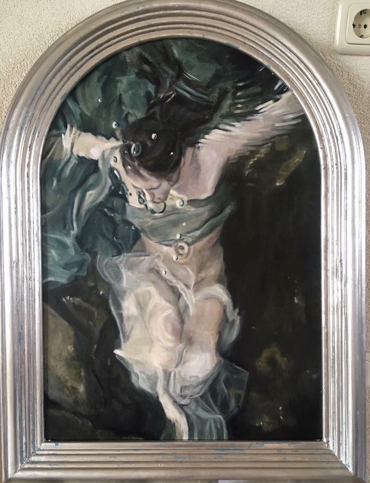

I adore tabernacle frames. But I’m afraid my frames are a little more plain. They’re simple frames with an arch at the top. Let me see if I can figure out how to add a photo. [img][attachment=1]IMG_3215.jpeg[/attachment][/img][img][attachment=2]IMG_2526.jpeg[/attachment][/img][img][attachment=3]IMG_3210.jpeg[/attachment][/img][img][attachment=0]IMG_3214.jpeg[/attachment][/img]

Did you do that?
Absolutely magnificent. Puts us all to shame.
Can you say how you created the arch top? Was it a router?

I found a lot of unfinished frames at auction. They were from a furniture manufacturer that went out of business. I believe they were intended to be used for mirrors. Looking at the backs they were joined from multiple pieces of straight moulding to rough in the arch. And then likely routed, maybe by having the router locked in position and rotating the frame with a jig? I’ll post pictures of the back of the frames if anyone is interested. I have large ovals, small ovals, shorter and longer arches[img][/img].
I finish them as needed for paintings on panel, with either traditional chalk/rsg gesso, red bole and Dutch leaf or blue bole and silver leaf. I used to cut the panels and shape them by hand, but my boyfriend is a woodworker! and now cuts them in a jiffy on his band saw for me.
As an artist I’m really drawn to unusually shaped frames. I have enough now for some time, but will need to come up with another solution when my current supply runs out.

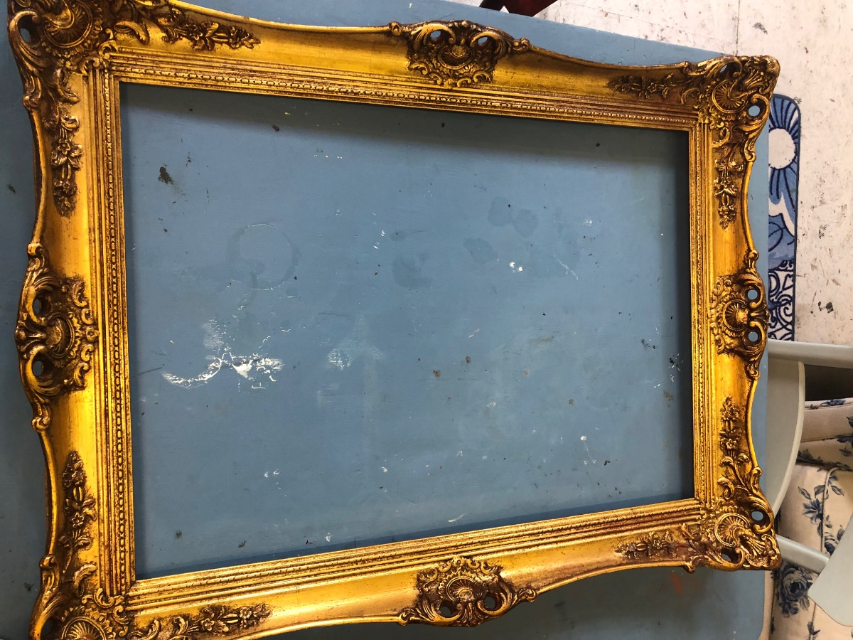

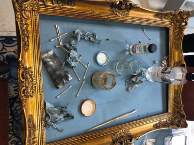

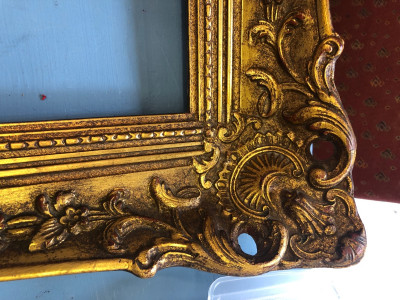

I did just pick up a second hand swept frame. I’m guessing from the 1960’s or 70’s? It has a heavy handed brownish layer added to antique and distress the frame. I’ve “cleaned” out much of the that brown layer with a mix of ethanol, turpentine, and brush cleaner and scrubbing it in with old hogs hair brushes. I’m re-leafing it with imitation gold leaf to match a painting.
Here are a few progress pics. Unfortunately in reverse chronological order. I’ll work on mastering the quirks of posting images!

For the swept frame you showed. I'd use a water-neutralising paint stripper.
Let the stripper blister up the finish then clean/neutralise the stripper with methylated spirit instead of water.
That way the meths evaporates off quickly and there is no water to dissolve the underlying gesso.
