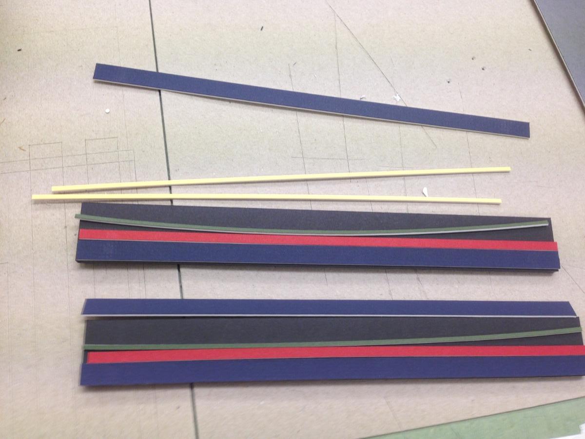

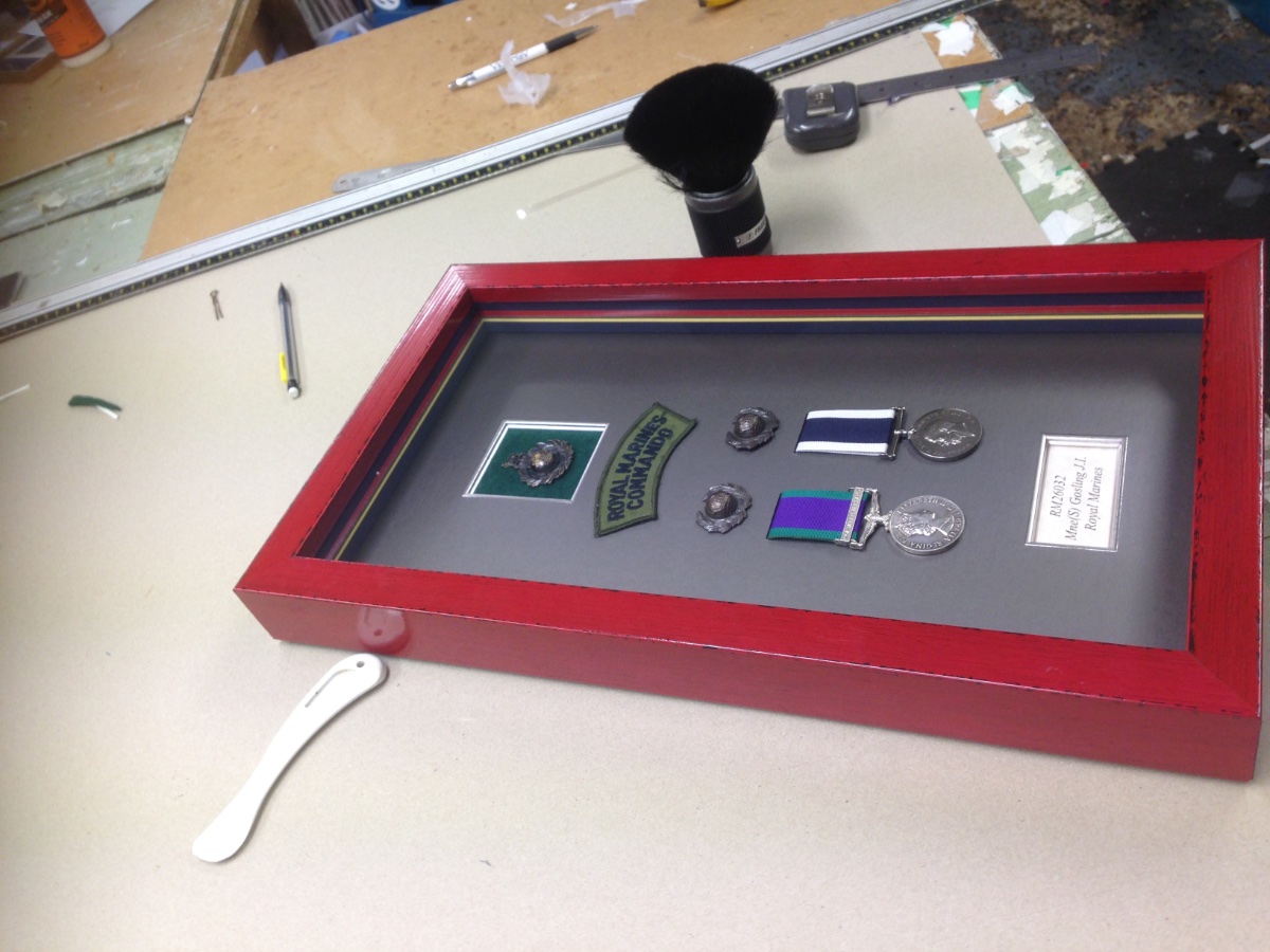

Here’s some spacers on acid
I framed these medals etc as a POS display in the shop - the regimental stable belt colours in the spacers.
It sold SO many jobs. Some of those jobs unfortunately had to include regimental belt colours too, there were many that were a total pain, but I think the Royal Marines’ was the worst!

That’s some skill there,are those narrow ones cut by hand ?
Looks very time consuming
Neal
Neal
- Posts: 830
Re: Self Spacers
CMC - but would be do-able on a keencut gold
