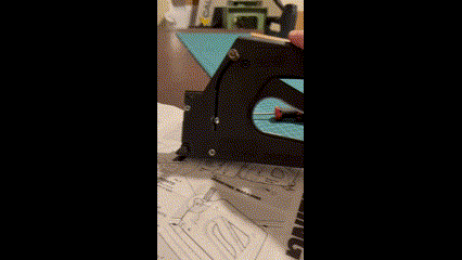

My Fletcher Framemaster Point Driver decided to have a hissy fit. :? The 'trigger' suddenly has no resistance, no 'click' and won't fire any points. Nothing is jammed that I can see and nothing happened before it just suddenly stopped working.

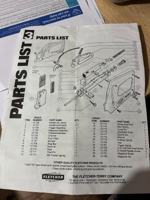

I've been looking through various threads and can see that some things are fixable, albeit a bit of a pain, but I'm not sure what the problem is to know where to start. I'm happy to have a go taking it apart but before I do, would anyone have an idea of which bit is busted? I have this diagram (and visions of an exploding avalanche of 'bits' if I touch the wrong part...)
I'm thinking it could be something to do with part 22, the trigger spring but any pointers would be much appreciated. Thanks!

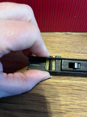

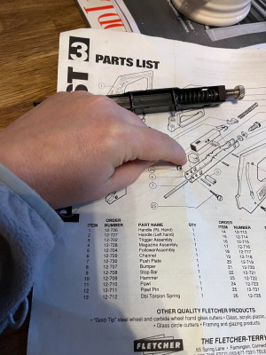

I've been fiddling and taken it apart and the only bit that is obviously broken is this nylon (?) bumper - part 8.
I'm not sure what the bumper does, but would that cause the symptoms? I'm not saying I will be able to actually get it back together again, but Lion sell the part so its worth a try.
Re: Fletcher tab gun - repairable?
Yes that would do it! That bit is quite skwishy and behaves like a shock absorber. It is necesary to limit the impact of the hammer blade against the tab being fire into the frame and it there prevents excessive impact damaging the hardened edge of the hammer blade. After a while, the plastic block goes soft and shrinks in size, that sort of material is a plastic type known as an elastomer. You can easily cut a new one from a white plastic pencil type rubber. It won't last for ever, elastomer materials evenually lose their physincal properties and when that happens it's time to cut a new one again!
The hardened edge of the hammer blade has been treated to harden it, which also makes it subject to britileness, if the impact becomes excessive and if you are trying to drive the tab into something very hard, such as a knot in a piece of hardwood, allowing something to give a little will extend the life of your and prevent premature failure of your tab gun. I've had one of those fail and needing to be replaced myself, so yes that's what it is!
