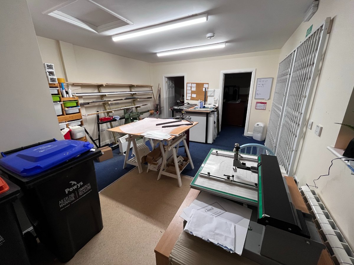

Just an update. Thank you for all your input but I didn't get the grant in the end. Boo.
The feedback was that a new fund is now being offered that would be more appropriate. Fair enough. The other issue is that I didn't ask for enough funding (!) and was below the minimum threshold. I asked for £500, the minimum is £1000. I've been advised to increase my request and apply for the new fund. Which sounds great on the surface (free money), but as any award is match-funded means I would need to find £1000 to start with, which I simply do not have.
As well as some fairly strict clawback clauses spanning 5 years, it makes what sounded a good deal potentially becoming a bit of a millstone. So I will probably just carry on as I am in terms of my outfit and focus instead on trying to bring in more business. At the same time keeping an eye on here and ebay for 2nd-hand bargains.
