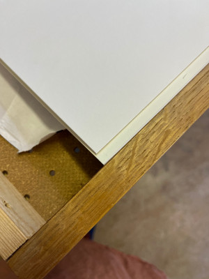

When I took over the workshop I got a lot of coloured mat boards. Stored in these drawers. Sadly a lot of the mat boards have scuffs/scratches in them. (I’ve read a little about how to try to save them.)
How should I store my new ones so they don’t get scuffs/scratches? Some kind of paper between them? What kind? A new storage solution?

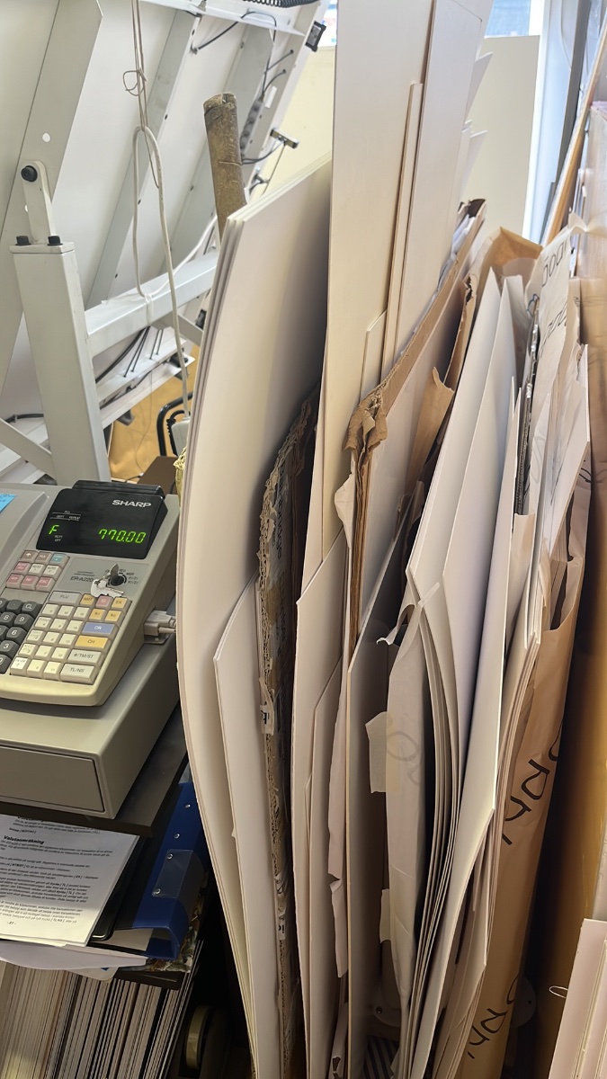

Do you store white daily use mat board and back board vertically as well?
I have this from previous owner. I’ve tried to organise with dividers but it’s always chaos.
So I thought I’d use the plan chest more. Maybe I have to rethink again. Especially since Oppboga mat boards don’t fit in the drawers. Munken fit!

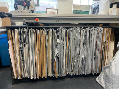

All boards stored this way. I suggest in whatever order makes best sense to you, be it by colour, product number, whatever. Vertical storage is so much easier. We designed a table to take our CMC. 18mm MDF for top, base and sides with 9mm MDF dividers every 10cm. Solid as a rock.

I have a convenient gap under a staircase where I store all my mountboard. The packs are stacked end-up and the colours
are separated by 4x3 sheets of 2.5 MDF. Over ½ sheets are returned to any opened packs and less than ½ sheet off cuts are
stored in a rack on castors.
Sheet materials are notoriously hard to store but storing them flat is probably the worst way to do it.
It depends a lot on the space you have available.
