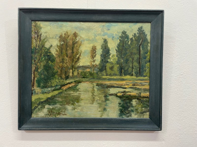

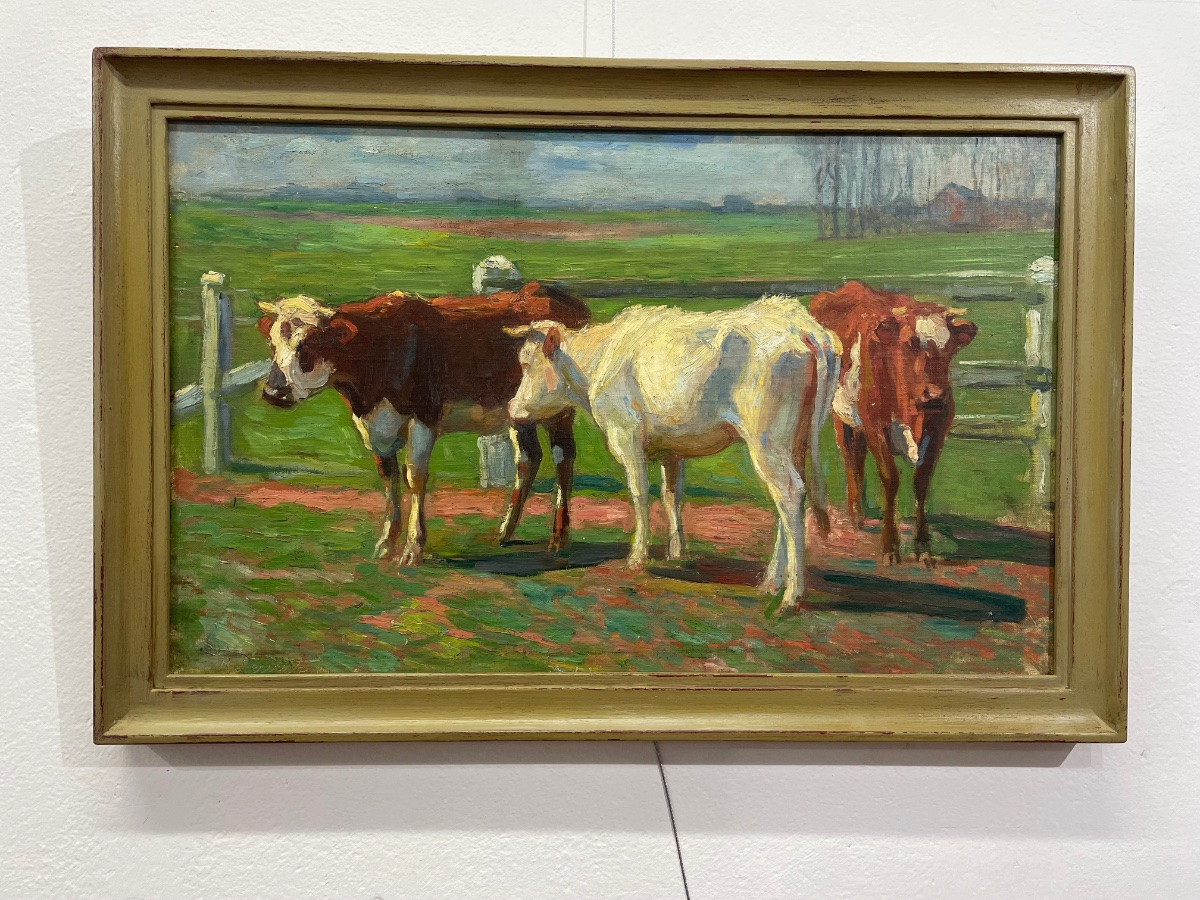

FYI here are a couple of the frames I did for that customer.
- Posts: 1636
Re: Aging/distressing
That is working really well for you.
