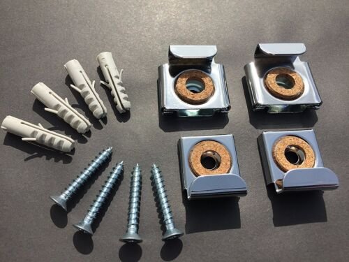

You could use mirror clips. Something like the attached photo.

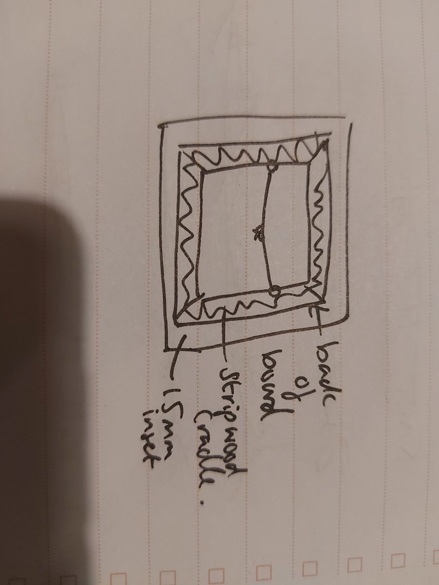

I know you're sorted now but another suggestion is to add a 'cradle' to the back - cut a simple stripwood frame (I use 18mm from b&q) about 30mm smaller than the board. Inset it 15mm all round so it doesn't show, glue it on with titebond, d rings and cord as normal. Minimal cost, ready process, but secure. It also helps keep the board flat, as they have a tendency to bow.
Obviously though it's permanent, so they need to be aware. Also means you can tray frame it when they realise how much better that will look!

I like the sound of that, but do you need to apply it all round rather than just the sides - is it likely to distort if you only do the sides?girlfromkent wrote: Fri 31 Jan, 2025 9:03 pm I know you're sorted now but another suggestion is to add a 'cradle' to the back - cut a simple stripwood frame (I use 18mm from b&q) about 30mm smaller than the board. Inset it 15mm all round so it doesn't show, glue it on with titebond, d rings and cord as normal. Minimal cost, ready process, but secure. It also helps keep the board flat, as they have a tendency to bow.

You'd need to cradle it all round. I'll try to attach a pic.
