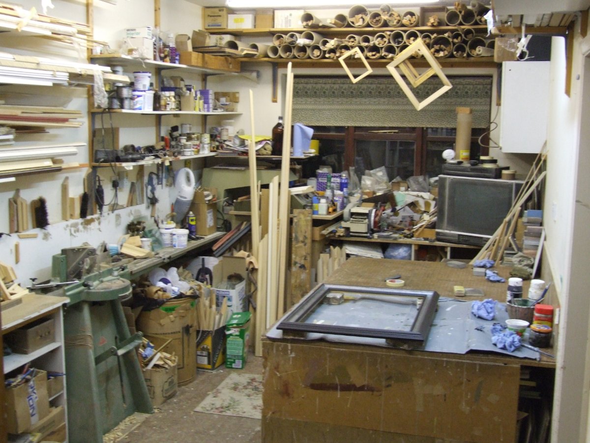

I have three working platforms....
One is 6' x 4' x 33" high. I knocked it up 40 years ago and it has served me well. These days it's my dedicated 'mucky' bench
for frame assembly and frame finishing. The top is ¾" chipboard which I cover with a sheet of MDF. When this sheet gets too
disgusting I flip it over. One sheet lasts a good while.
For mount assembly I have an A0 drawing board with the parallel ruler removed and a cutting mat on top. This is a better height
for such work.

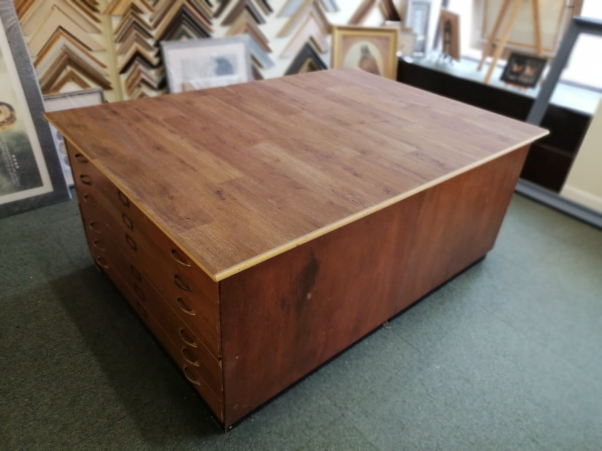

For a 'clean' assembly bench I have two plan chests back-to-back topped with chipboard and Flotex carpet on top. This carpet is
the best thing I've found.
This is the disgusting bench....
for such work.

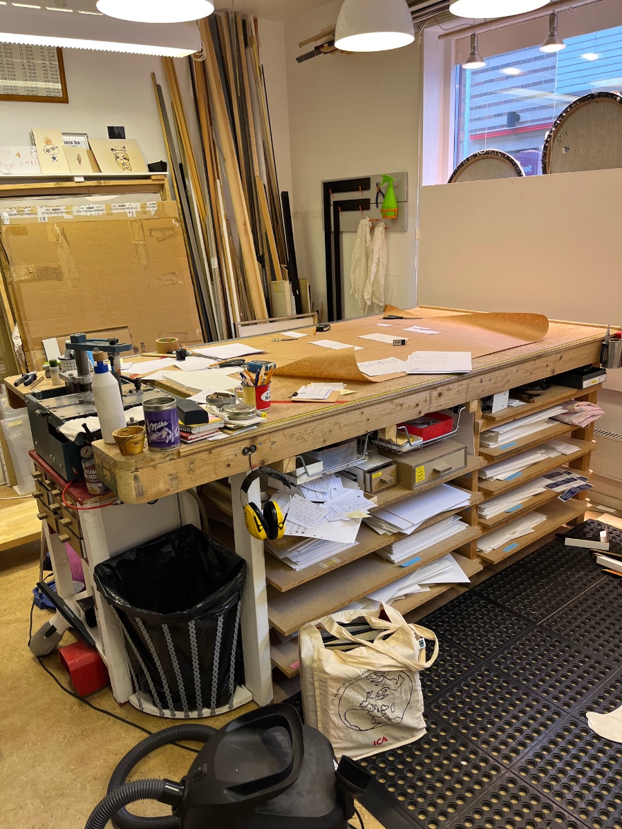

Re: Framing Workbench Design

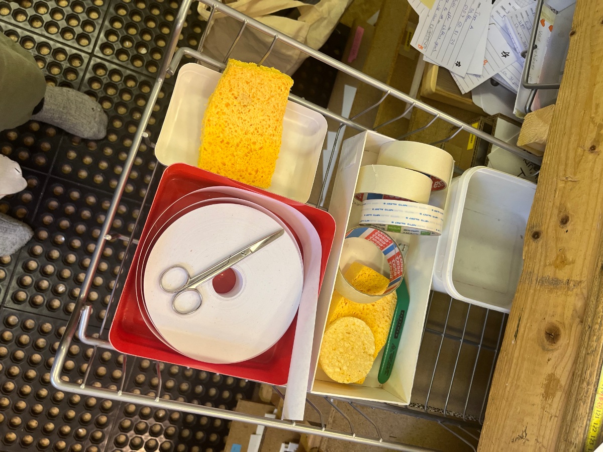

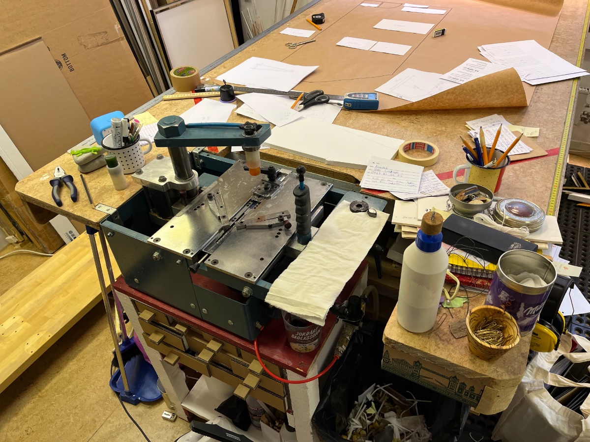

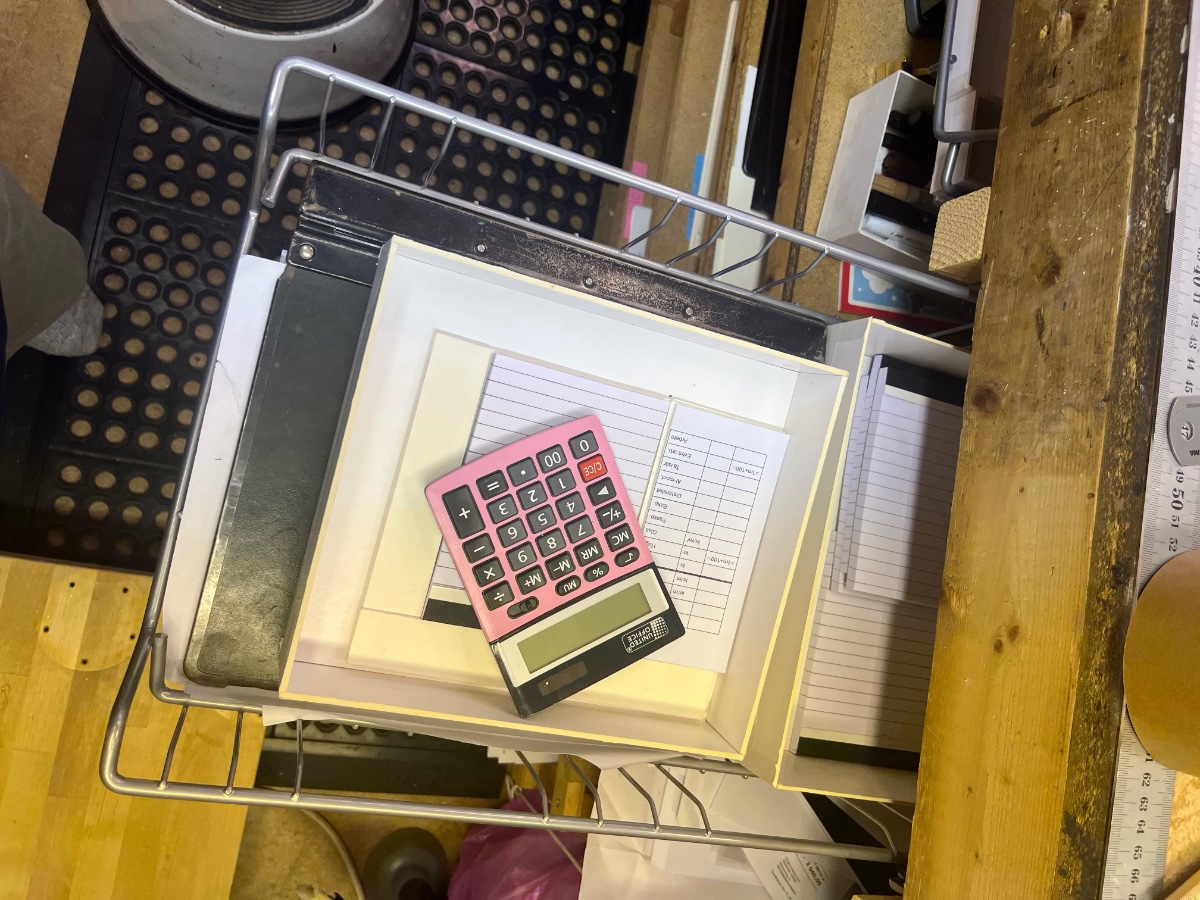

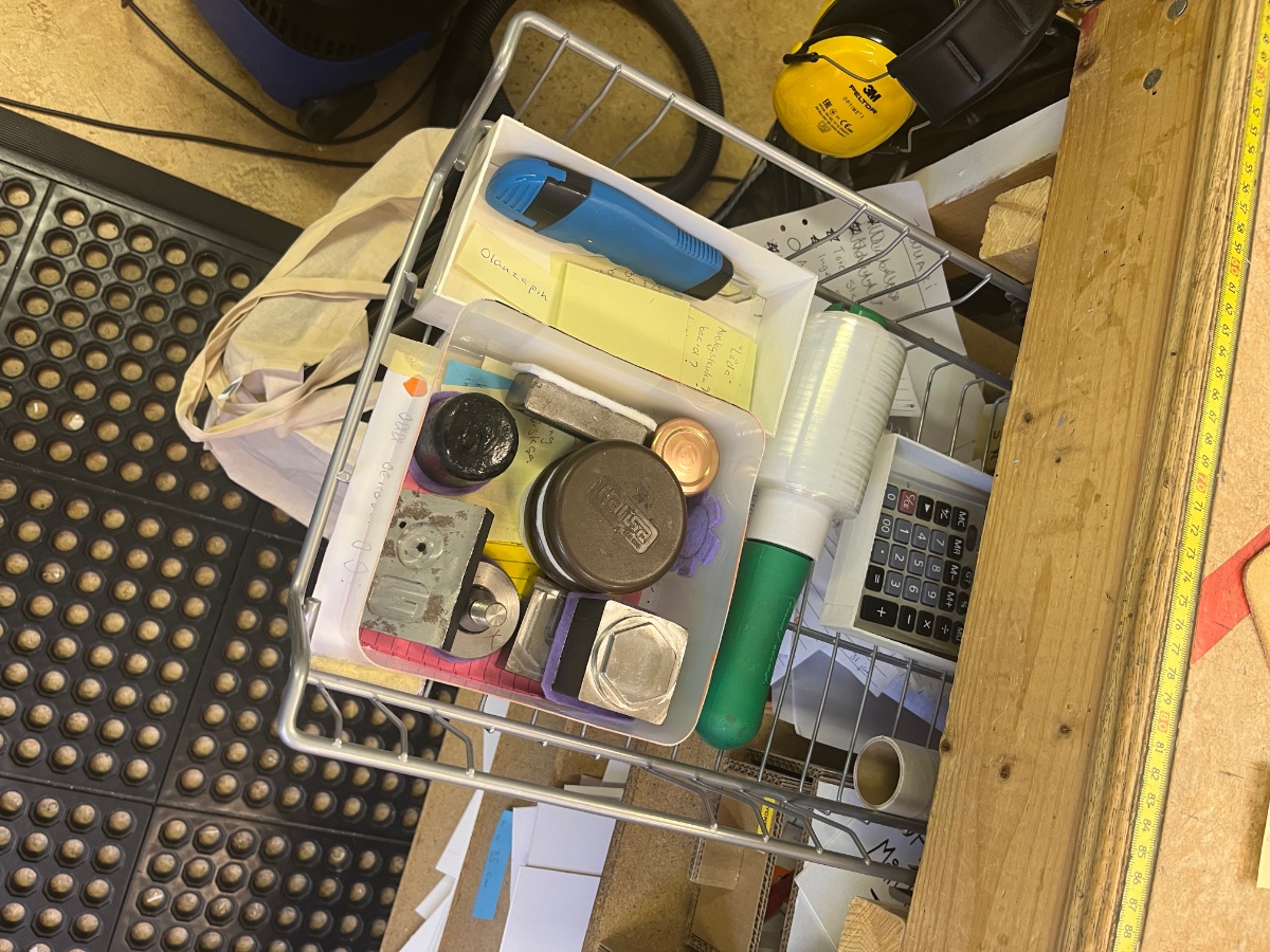

This is my table (and mess). The previous owners made it. Except the drawers, me and two of my kids mounted them. I only have one table. (I’m in the process of planning for a second table. It’s the floor plan lying on the table.)

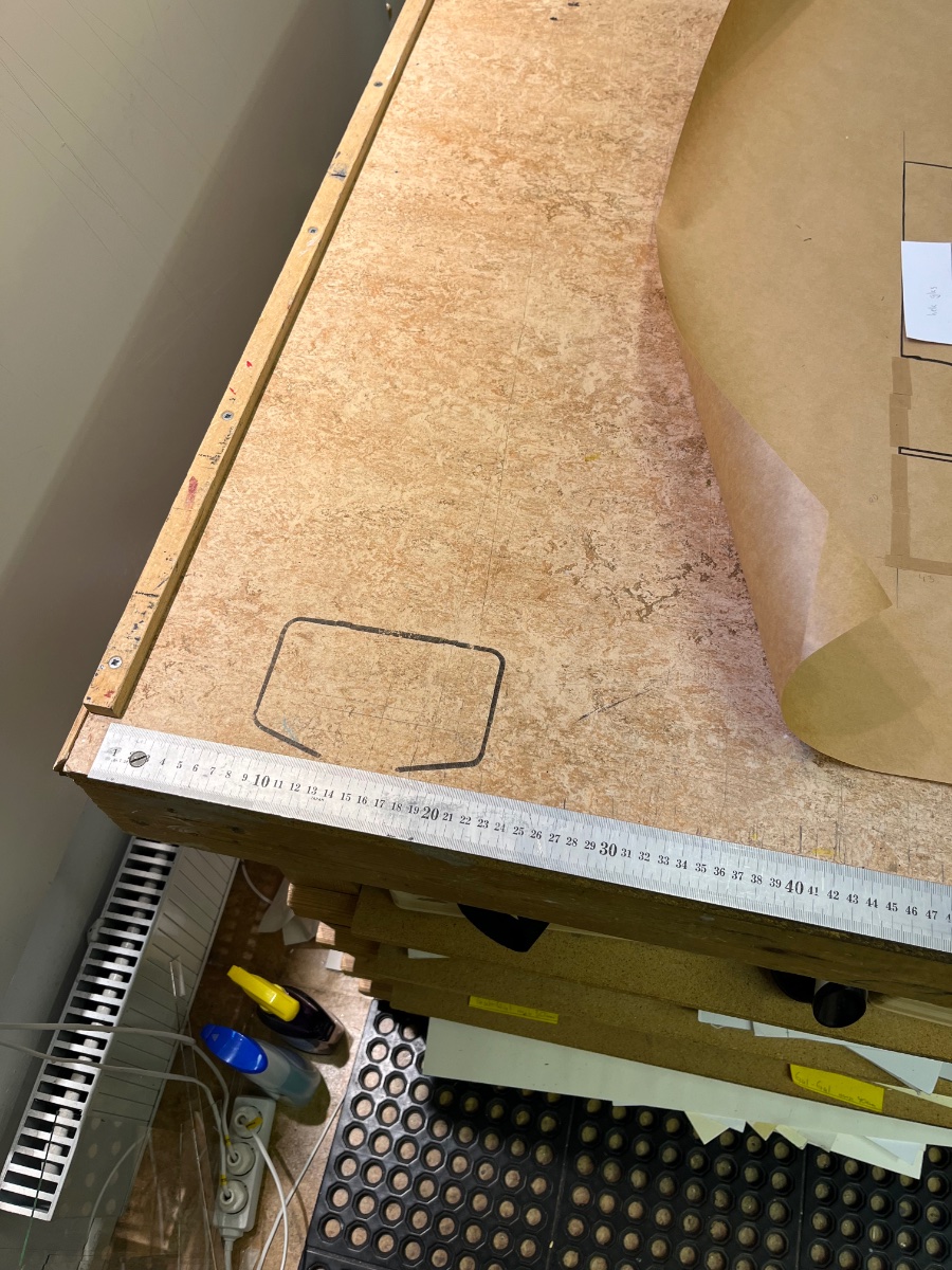

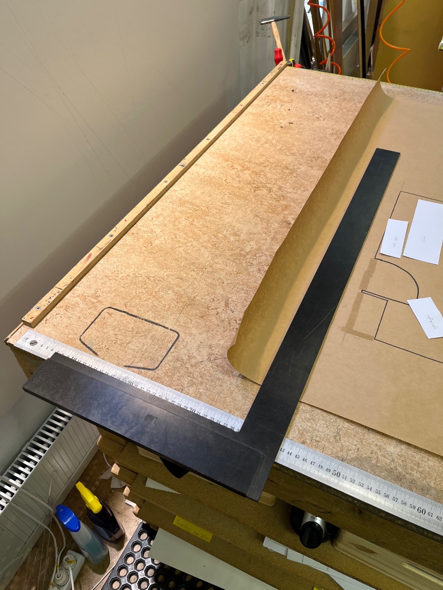

I cut glass, mount board, mat board and assemble on it. The top is linoleum flooring. (It’s time to change it.)
The size is 120 x 225 cm. Height 93 cm. I’m 170 cm. Sometimes I wish it was 140 wide.
It’s very easy to measure and cut glass with the rulers and “anhåll” (no idea what’s called in English).

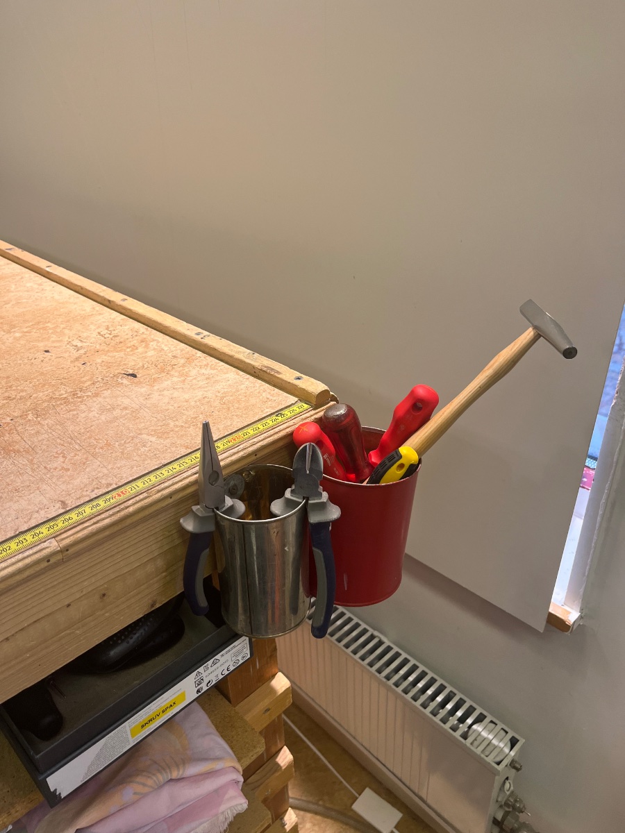

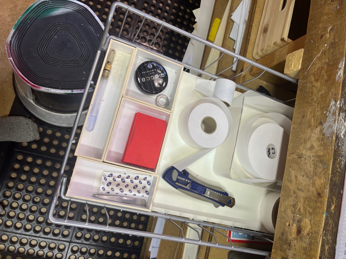

I have organised so everything is handy and close. It’s like I have different workstations on the one table. Instead of having all the tools in one place I have several for example scissors placed where I use them.
I’ve been thinking of placing a camera and film for one day. So I can count how many times I walk from one side of the table to the other.
