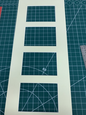

I posted on here about six months ago about niggling issues in cutting multiple windows in a given mount.
I'm trying one again, and even though my use of the manual cutter isn't bad on the whole (I think), it just seems incredibly tricky to do multiple windows without glitches.

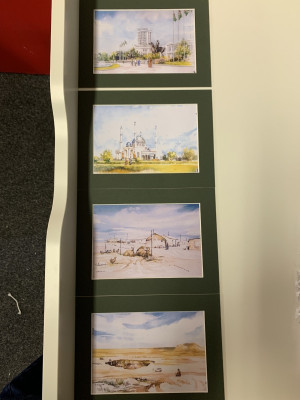

In this example, I've got 4 no. postcard-sized pictures that I'm putting into the mount. The ongoing issue I have is "hooking". This occurs specifically when starting one of the windows after the first one, and where the "start cut' measurement is therefore effectively not used.
I don't wish to dismiss the aforementioned conversation where many of you offered some detailed advice (especially John/Roboframer's step-by-step I instructions) on using a manual cutter, but what I want to ask is...do any of you really do multi-apertures in this way? Or do you all just CMCs anyway?

Is there a bit of a wiggle to your cutting head? Or it could be the pressure and angle you're cutting at?RobM wrote: Fri 14 Feb, 2025 3:32 pm I posted on here about six months ago about niggling issues in cutting multiple windows in a given mount.
First, check the cutting head. I'm using a fletcher so an allen key adjustment controls the grip/wiggle on the metal rod.
Second, check your position and how 'intent' you are on inserting the blade on second window cut. When I've been cutting multiple windows I found moving my mount cutter height to a bench at waist level helped. I found I wasn't pressing down on the blade as much.

As your machine is new, I would guess this technique. I suggest trying using your left hand to hold the guide still (as you do when making the first cut) even though it is not at the edge of the board, and see if you can plunge the blade cleanly. I suspect the cutting head is moving as you make the plunge cut.RobM wrote: Mon 17 Feb, 2025 9:28 am
To me, the hooking seems to occur when I insert the blade without using the guides (on the windows after the first) meaning I'm slightly less sure, and not holding the top guide down, and so perhaps there's less force when breaking the mount?
Another way to approach this, assuming you have marked in pencil on the back of the mount where you want the cut to start. Is to start the cut earlier, but to start by scoring the mount, not cutting through, and increasing depth gradually, this will 'set' the blade at the right angle, and possibly avoid hooking.
Either way, just need to practise until you build up the muscle memory!
