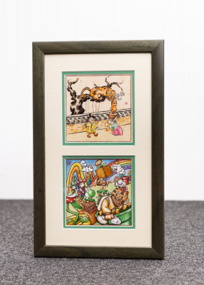

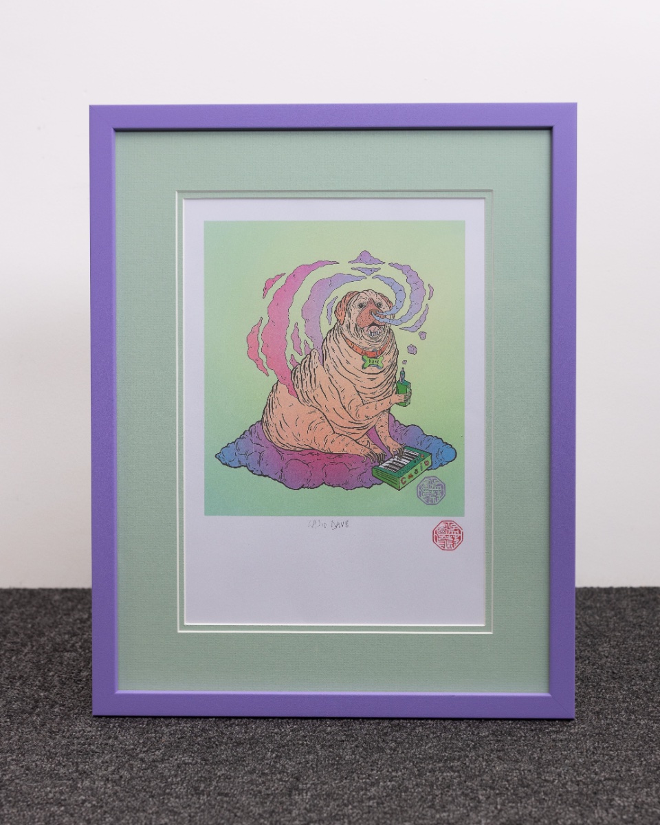

Ashgabat - Are the mats too white? I'm really getting used to how we use choose light or dark mats based on the lightness of the pictures. Just thinking it needs more somewhere...if only I knew what...

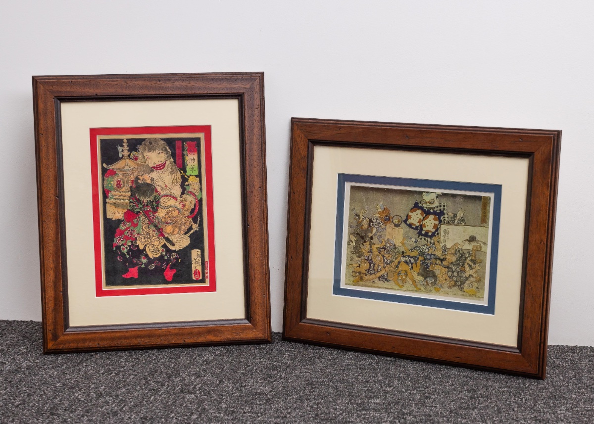

ukiyo pics - I'm quite happy with these - similar pics with only in the inner mat differing to go with colours within the individual images. The dark wooden mouldings make them look old or classical. But what could be done differently?

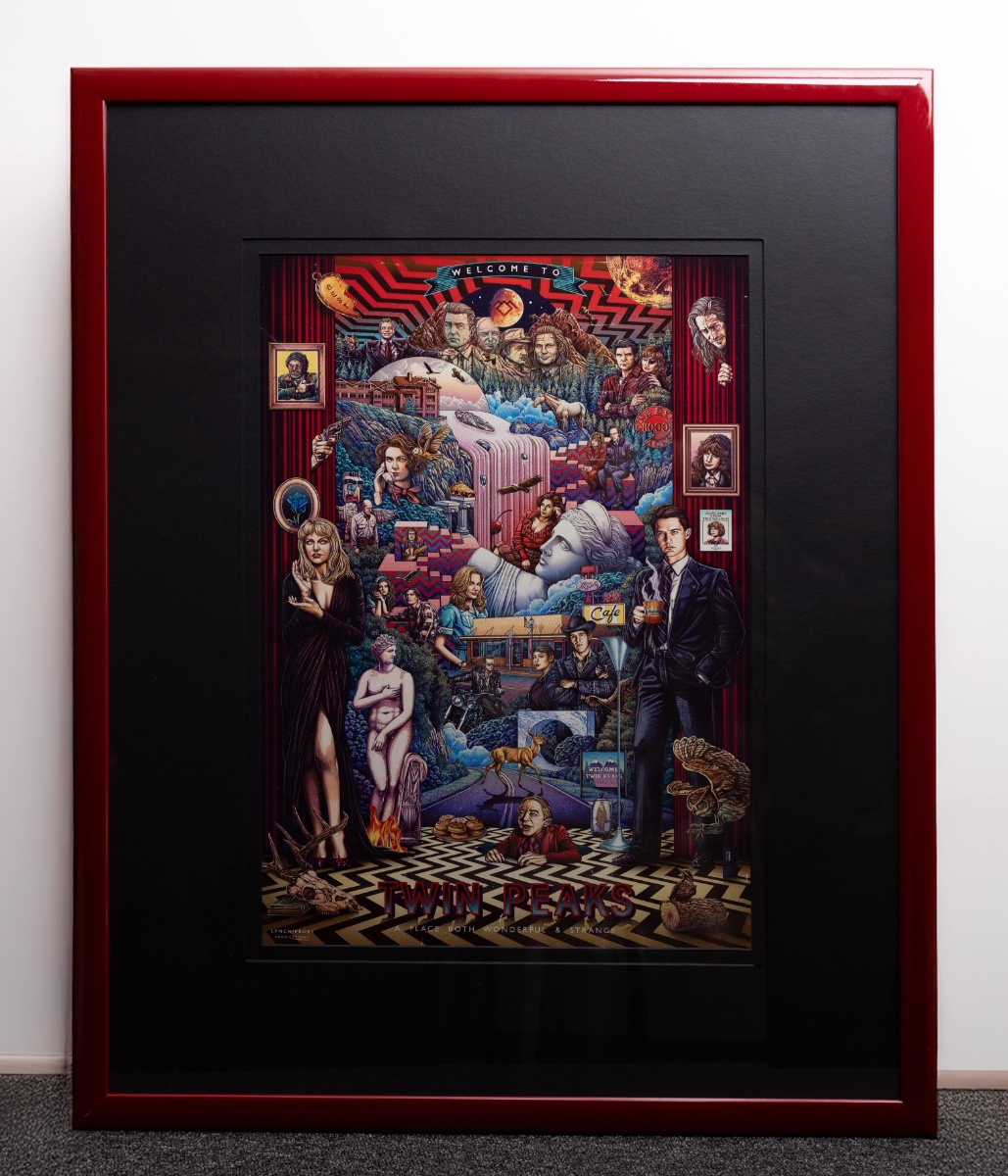

twin peaks - the idea here was to use dark mounts to go with the dark spots in the pic and also to reflect the aesthetic of the show, and the moulding also reflected a colour within the image. Somethings really bothering me about it though. Is it too dark? Should more be made of the frame? Is AR glass essential when using so much darkness?
Casio Dave - actually happy with this one mainly in using colours within the image to complement it, but am I being cocky here?
Thanks for looking!

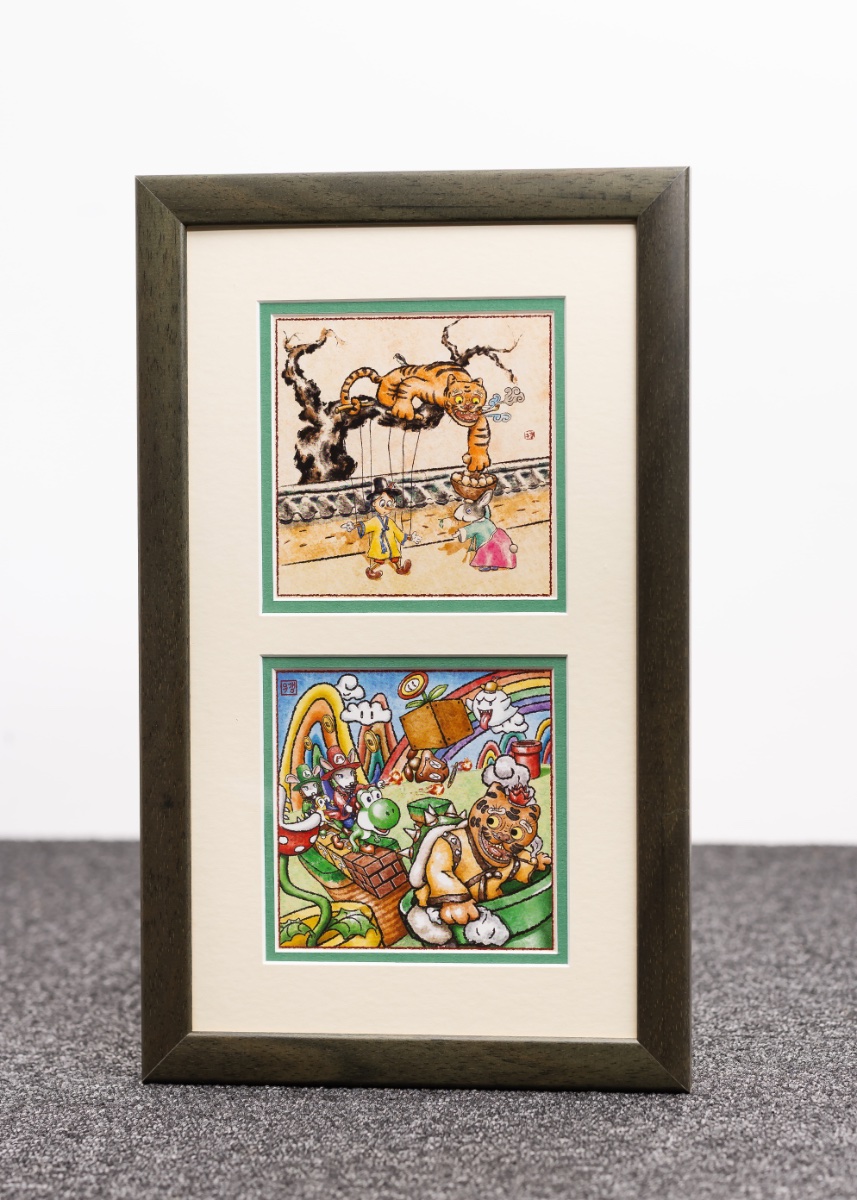

Korean Comic. The cream mount looks fine, the green works on the bottom I'd try a different colour above. I prefer thinner more subtle slip of second mount colour like 4mm. The frame adds nothing Imo.
Ashgabat. This is an example of when the frame moulding totally over powers the piece. Close your eyes, open them and what's the first thing you see? It should be the artwork. If they insist on that moulding, the mounts need really careful thought to enable them to draw your eye in towards the work.
Ukiyo. These coloured undermount are far too wide and over powering, the top mounts too narrow and the mouldings feel dated, not in a good way. They're making no reference to the work's style or origins.
Twin Peaks. This looks great to me. The moulding colour is great. I'd probably just use a single black core onyx mount.

Very useful comments here, Justin, and it's interesting hearing that the one I was most worried about was not so problematic!
You nailed it re: Ashgabat. I think the frame looks nice on its own, but yes, it's too strong for the image contained therein. I guess you would favour a black/grey moulding if you were choosing the frame for this?
Otherwise, I think the theme might be that I've tried too hard to make a show of the frames without considering the impact on the art itself. I suspect this is a common error for newcomers.
I'm actually now just making my way through the Perkins book after your own prior recommendation. It is really handy, and I'm forming more ideas off of it.
Thanks!

Justintime wrote: Sun 09 Mar, 2025 9:12 pm Korean Comic. The cream mount looks fine, the green works on the bottom I'd try a different colour above. I prefer thinner more subtle slip of second mount colour like 4mm. The frame adds nothing Imo.

I agree with Justin's comments above - keep the undermount to 4 or 5mm.
On something that has loads of colour, or 'extreme' colours think about a really understated presentation that allows the image to do its thing!

With Ashgabat, it's not necessarily about the frame colour, but about being sympathetic to the period or perceived period or stye of the piece. In order for the framing to elevate a piece, making it feel much more than the sum of its parts, it all has to work together, to naturally and effortlessly draw your eye to the work.

I now see what both you and Justin are pointing out. Note: don't be overzealous with the undermounts.
