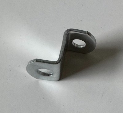

I was thinking, may be mount the board on a wood backing, and use these:
to create the illusion of thickness, but this is probably a crude method.
Any pointers would be most welcome.
