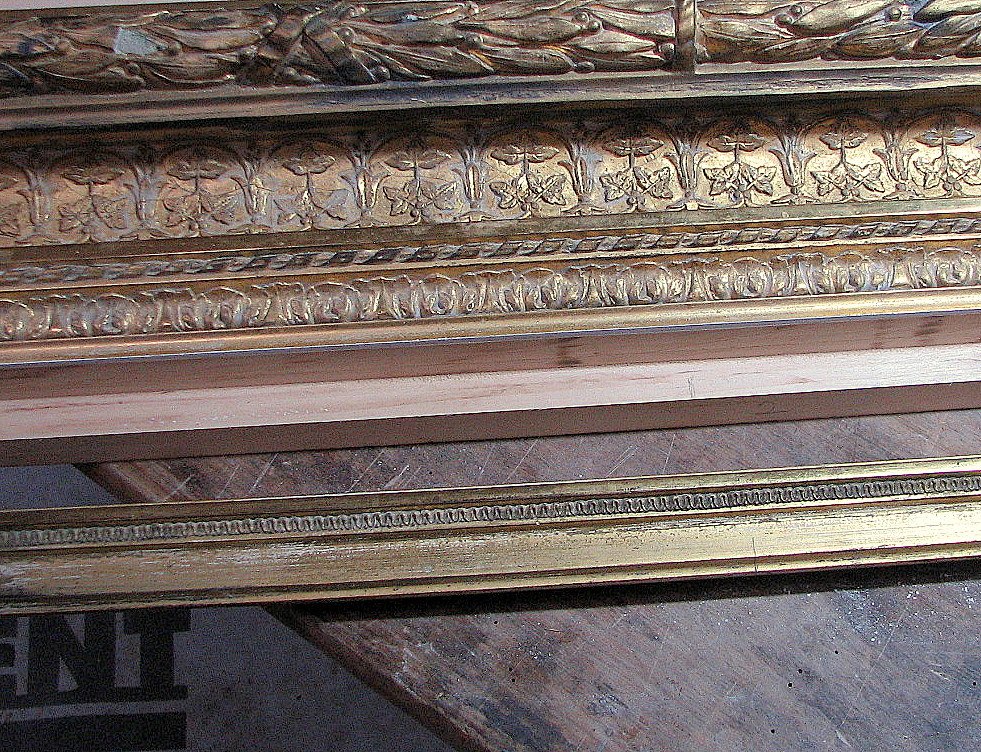

The frame is taller than the painting, so that bit was easy enough as all I had to do was shorten the two side pieces.
The painting however was about one and a half inches wider so the only way to accommodate that was to move the sight edge and rebate deeper into the frame profile.
Luckily the frame was an extravagant eight inches wide, so the profile wouldn't have missed or noticed the removal of some elements from the centre area.
You can see that from the photos,

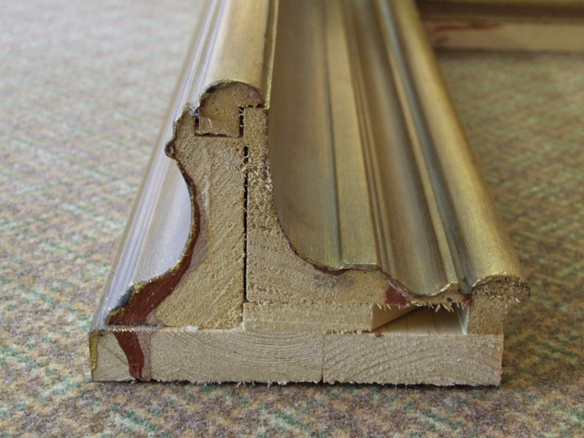

In this photo I've cut away the front section along the orange line and then machined out the hatched area.
This was done so that same front section could be lifted back and replaced inside that channel.
This photo shows how the remodelled profile fitted together,

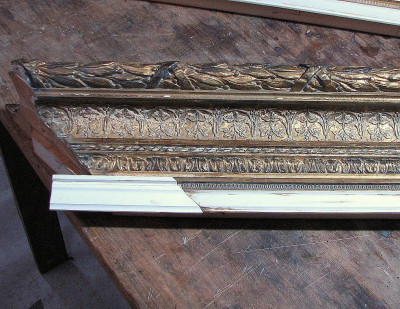

Of course I had to create an infill moulding to make up the length shortage of the front section and as the gilding was pretty manky on the other three sections, it was better to strip back to the gesso and be able to create an homogeneous finish over the entire inner section of the frame.

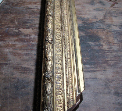

And here we have the frame all joined up the right size and ready for filling all the gaps and cracks and further gilding.
