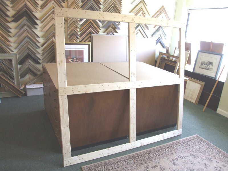

This is one a made for a giant-sized frame. It uses (quite cheap) 8mm thick pine cladding to make a relatively light but VERY
strong and stable structure that takes all the weight. The two-layer construction allows half-lap joints to be formed without the
irksome chiseling. Just a bot of glueing and screwing. The frame that went around it was in fact quite chunky, but I could have put a
very skinny one on without affecting the overall integrity.

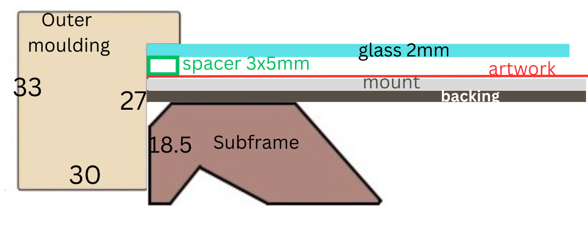

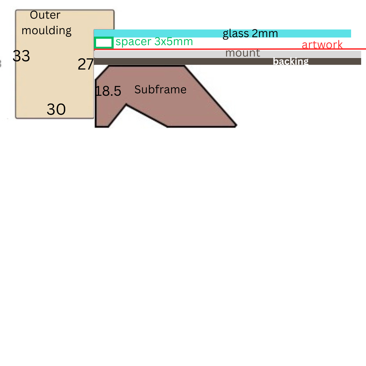

Went to visit Wessex framing supplies and finally seen in the flesh how a subframe works. This is the first and hopefully last time I will show clients an undersized moulding. Good job the community saved me from making a flimsy frame.
The moulding I have shown the client is also available in 30mm, which seriously increases the glueing area and give me a much deeper rabbet, which in turn allows for the sub frame to hardly add any extra thickness from the original moulding (+1.5 mm).
Would look like this:
One last question:
I dont plan to do a window mount on top of the poster. Is it safe for the spacer to be in direct contact with the artwork/poster? The very edges of the poster are not damaged, but they are a bit frayed on a couple of mils, being hidden behind the spacer would hide them. Or do i have to mount the poster on the mountboard (using gummed tape) so that it sits exactly ind side the footprint of the spacer?
Thank you
Fabulous, detailed answers. Thanks a million, really. Learning stuff – and I now have a proper 5-day training course lined up.
One last question:
Thank you
- Posts: 2550
Re: A rule of thumb for mould/weight calc?
There are differing views on this. I am happy to close frame the work behind the spacer, some are not. I hinge onto board, the top hinges are "tight" the surrounding hinges are "loose" (see Hedgehog technique) allowing for expansion and contraction of the work. If the backing board is not secured under pressure then I believe that the work can still move freely.
If conservation is important then everything coming into contact with the work must be conservation standard. The face of the spacer touching the work can be sealed with a white gummed tape or frame sealing tape, as can the inside of the frame, creating a conservation quality barrier between work and materials.
- Posts: 2550
On a piece that size I'd want a spacer deeper than 3mm. Standard spacers start at 5mm deep providing ample distance from the glass and can be joined on an underpinner using 3mm wedges. I wouldn't stress about the subframe extending a few mm more. If the subframe extended a lot more and you weren't happy with it, you could add an extension to the back of the frame as illustrated in a post I made yesterday.
