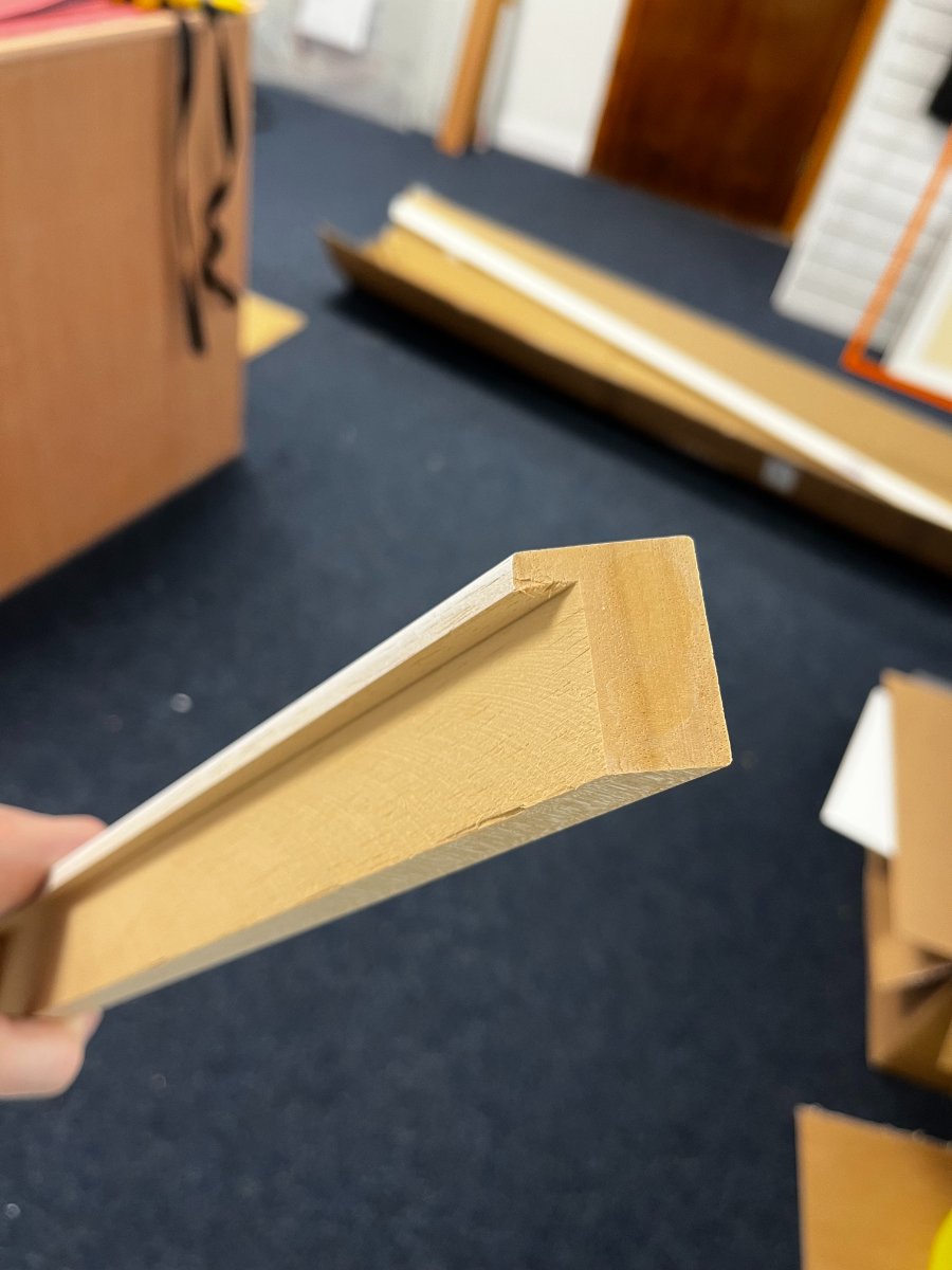

Hey all,
I'm having problems joining deep mouldings. Basically, I'm trying to stack 2 x 10mm (alfmachine soft wood wedges) and they're just sliding next to each other as opposed to stacking. I've attached a pic of the moulding - would someone know by looking if this is hardwood and if it requires HW wedges?
Thanks again guys!
Phil

Hi, that looks like ayous/obeche, standard SW wedges are fine. If they are inserting next to each other then moulding must moving during underpinning. What machine are you using?
I use a lot of 15mm wedges - it often avoids having to stack, sometimes when stacking they start to wander off and appear through the side

Thanks for the quick reply! Yeah I looked it up...it's ayous. I'm using an alfamachine U200p - it doesn't have the front clamp bit ....maybe I'm not holding it together enough. The biggest wedges I have are 12s so maybe I should get in 15s. There's always something!!!! Thank you!
