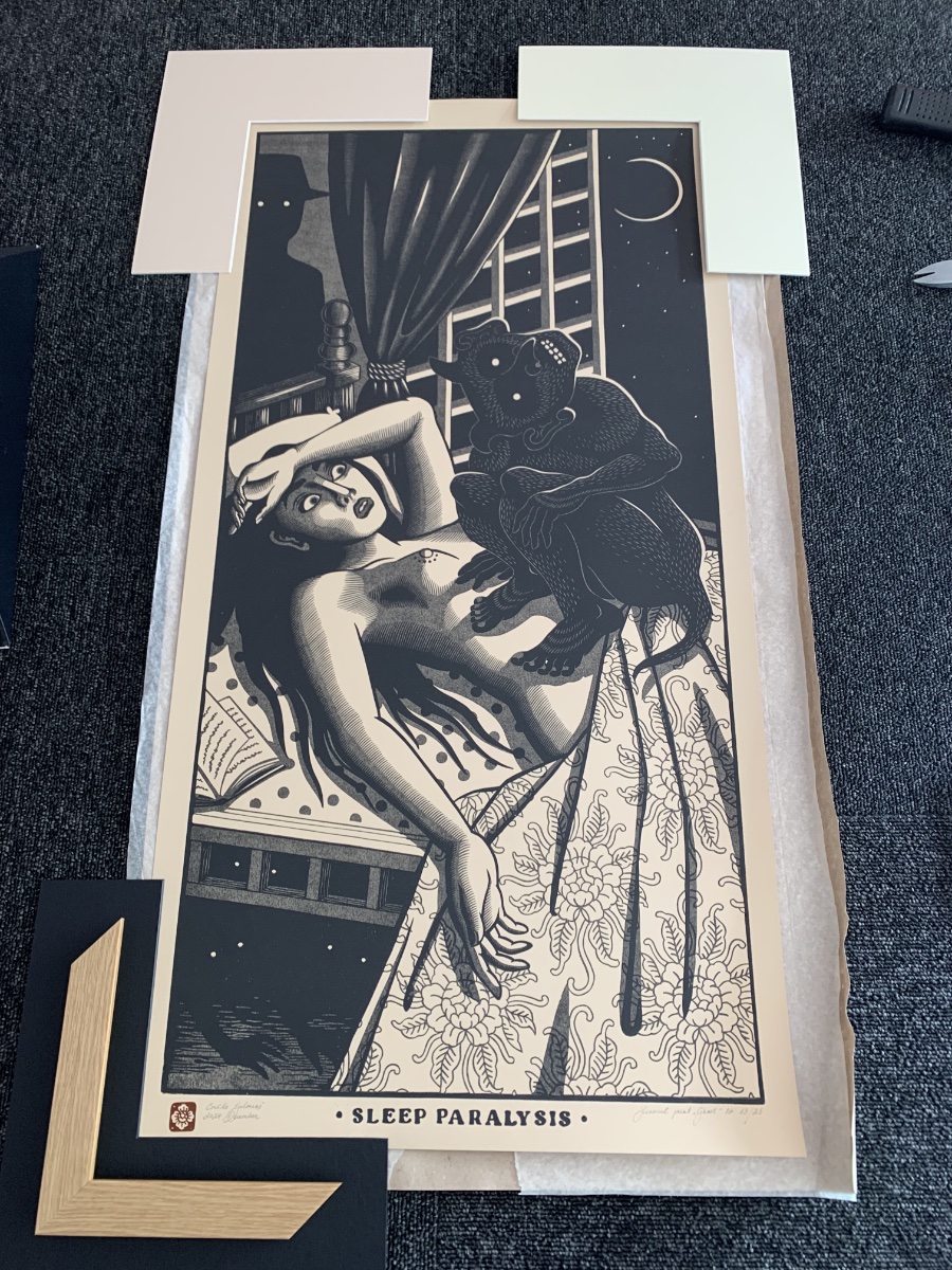

Sleep Paralysis - a print consisting of only two colours, black and brownish, my friend seemed to like an off-white/ivory mount, as those shown in the photo. I'd prefer to avoid those colours because, as was commented on one similar print I did before, the print tends to look "dirty" if the mats are lighter. For me, I can't see any other mount colour than black for this.
My friend did want to a brown wood-effect type moulding as shown in the photo. I do think this goes with the colour of the print, and with the black mount, there's a suitable combination, as per the bottom left corner.

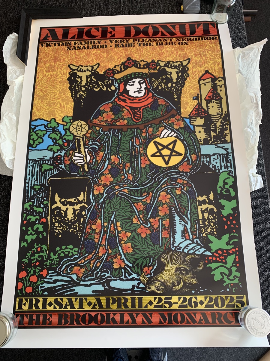

Alice Donut - a more colourful poster. there is a temptation to evoke the yellow and red colours of the title block in a mount. However, I can't help thinking a surround isn't entirely needed at all, because of the natural white border on the poster (I also wonder if this is a bit more normal on bigger images like this). So, I'm actually thinking no mount, and the shaped black moulding in the photo would be sufficient.

Sleep Paralysis - That paper is a tricky shade, I'd go with a Minuet mount or your black mount. If you're not matching that paper than I'd say stay neutral. I know you don't mind harsh so, I don't get how that Oak frame goes with the black. My eye goes straight out to the frame. If you stained that frame down with a dark shade then it would blend and help your eye be drawn to the print. Personally with that sort of print i'd go dark or black. If you're looking through catalogues of moulding samples, I'd look for a bit of texture on a dark moulding. The female body and the monster both have a bit of texture that can be mirrored in the frame if anything suitable is available. Have a look at Lions L2600 Rodin black to see what I mean. That moulding is a bit small for the piece I suspect but could be used stacked as the inside moulding. I'd also look at Larson Juhl 345082 and 439082 for some simple plain but stylish matt black moulding.
Alice Donut - You have an opportunity here to explore some mouldings with colour. There's greens, the dark blueish of the grapes. I'd stay away from the reds as you want your eye to be drawn to those shades and not be distracted by the frame. Black is fine too but..
As far as mount or not mount, I think both pieces could be hinged to board with spacers, "close framed", they'd look great with or without mounts.

While I'm gaining a better understanding of my design options in general, it seems there are still some basics I don't (at least yet, I hope) have the eye for. On Sleep Paralysis, I was thinking of the oak moulding because of the similar(ish) colour, but I'm still overlooking further factors, such as how some of these elements can distract from the image at hand. I particularly like the Lions L2600 example, but agree it might be a bit narrow on its own. I think I'll look at some darker browns and blacks that have some texture and sufficient width.
Just to check - Minuet mount is from Larson Juhl. Is there a reason that makes this stand out over other brands? Perhaps because of its conservation properties?
And Alice Donut - you're right, this is a great chance to play with some colours. I think I will add at least one mount, and I'm going to spend some time looking at options with coloured (but not too loud) frames.

There are a couple of Wessex mouldings (possibly also available elsewhere) that immediately spring to mind for the Sleep Paralysis poster.
MO4643 and D3753
Both dark brown / black with distressed gothic look - used them both on similar items.
MO4643 and D3753

Hi Jon. I think they would make suitable mouldings for that poster. I'm definitely a fan of the distressed look, as the texture goes well with the imagery, in the way that Justin suggested. I'm placing orders for some mouldings today.
Jon_Brooke wrote: Thu 05 Jun, 2025 2:38 pm There are a couple of Wessex mouldings (possibly also available elsewhere) that immediately spring to mind for the Sleep Paralysis poster.
MO4643 and D3753
