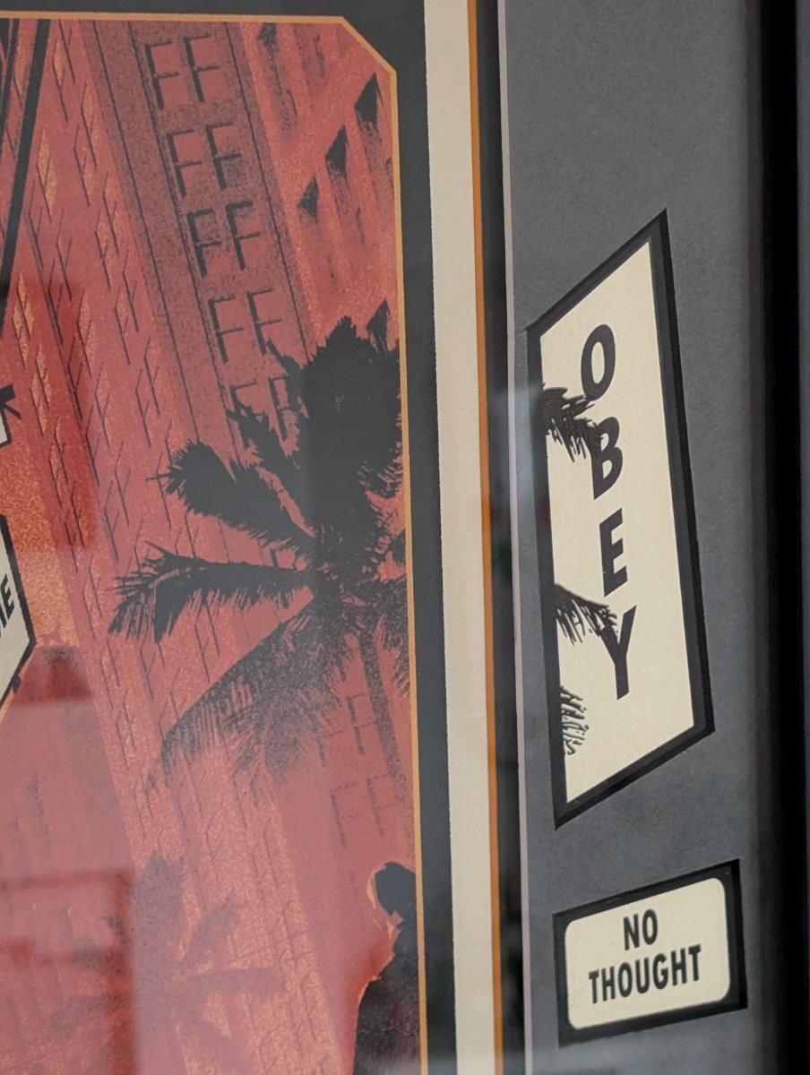

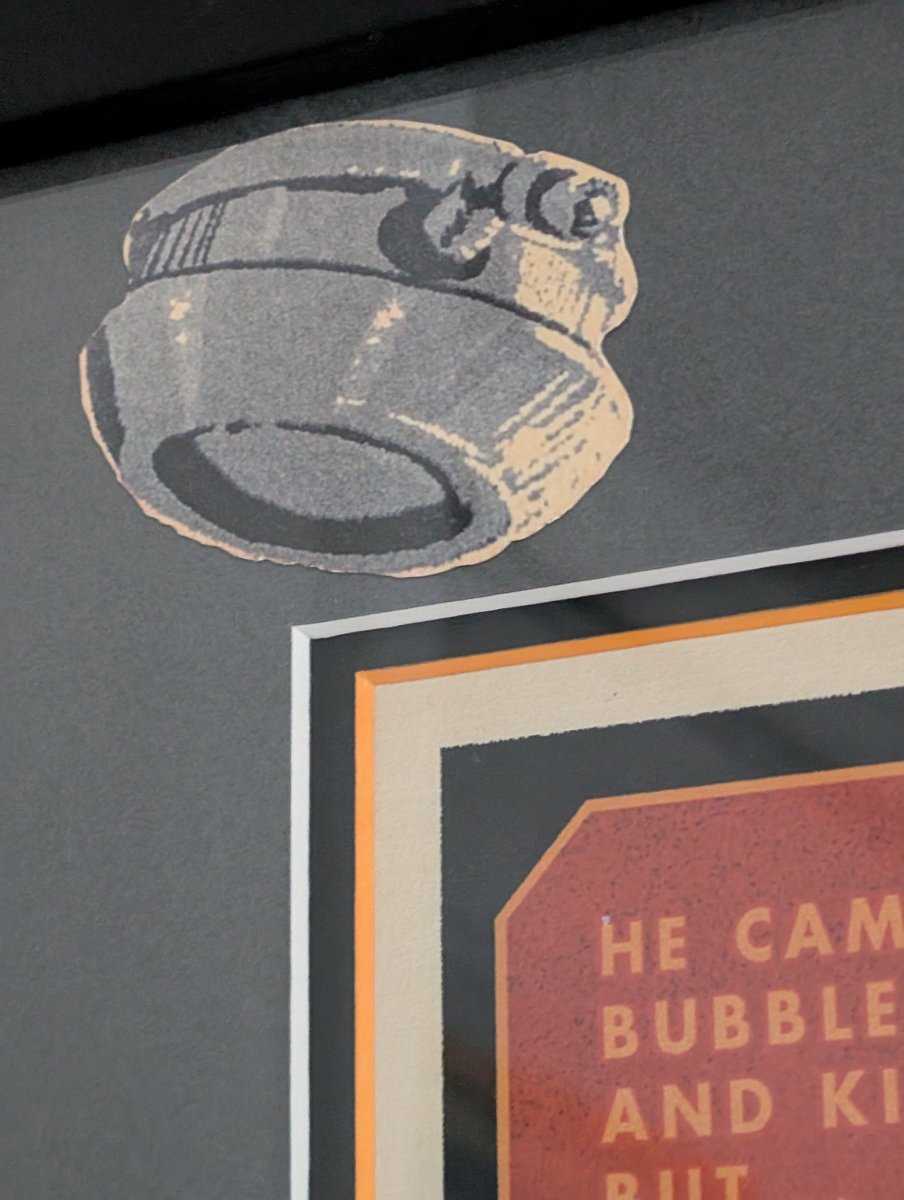

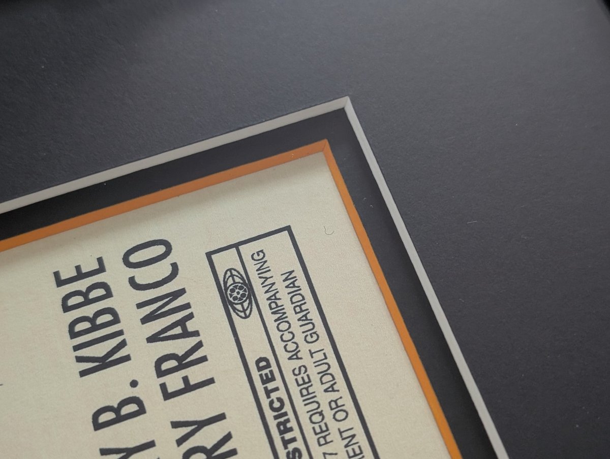

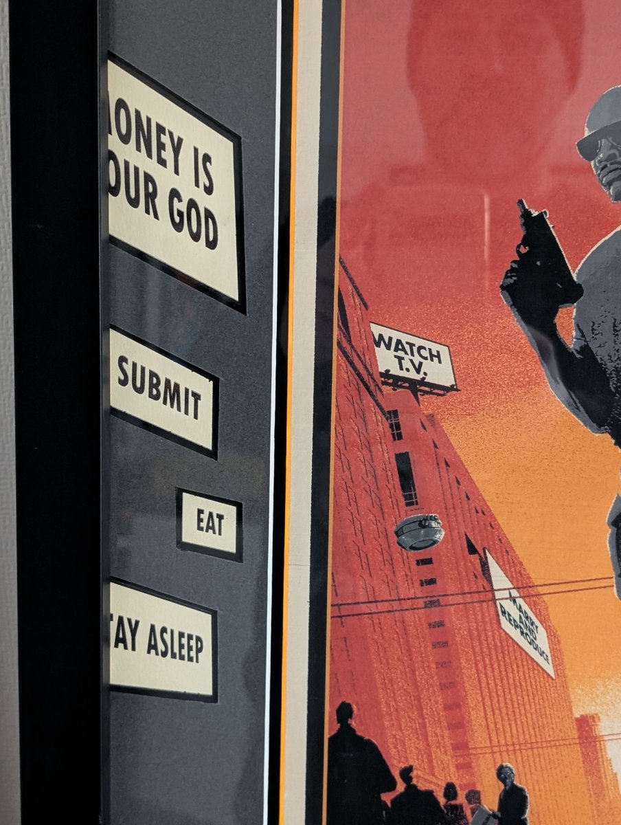

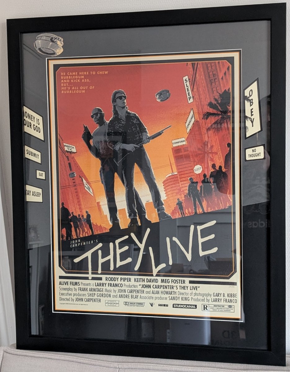

Hi Everyone,
I'm fairly new to framing, in that I've been completing projects in and around work and life events for approx 2 years.
I was hoping to take the leap into the profession but unfortunately that had to be put on hold. All my work at the moment is for my friends, family and for my own collection.

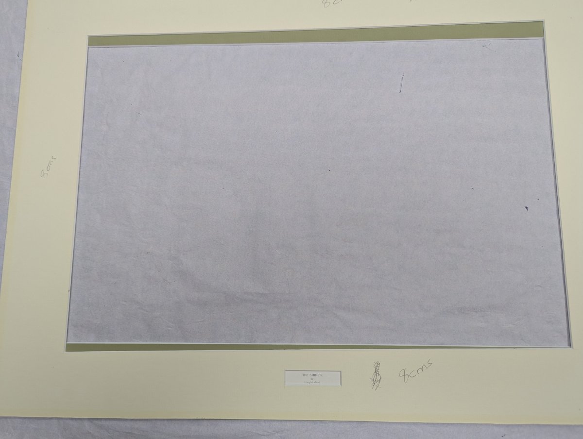

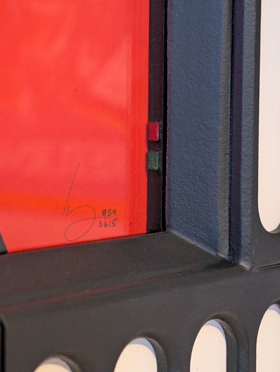

I just wanted to post my last 2 projects, completed this week, for some feedback.
As can be seen in "They Live", I'm having some issues with cutting random shapes without using the stops on my Ultimat Gold, resulting in some small overcuts but I'm hoping to iron that out with a bit of measuring but any advice on that would be greatly appreciated!

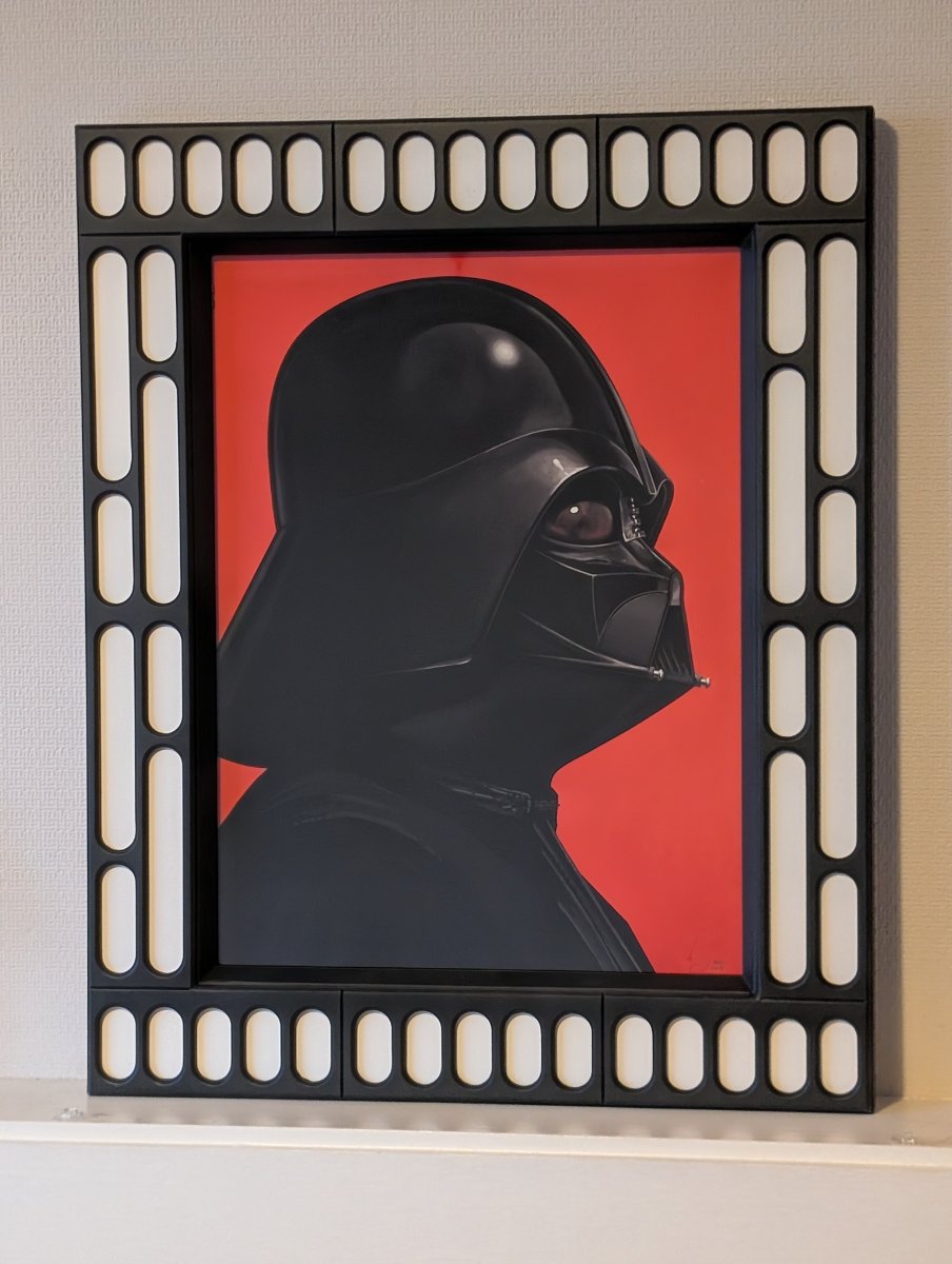

 - Posts: 2344
Re: THAT FRIDAY FEELING!
@rinzleriston I missed your post back in Feb. I can't believe noone else commented on it! These look amazing! Did you create and build the Darth Vader moulding from scratch?

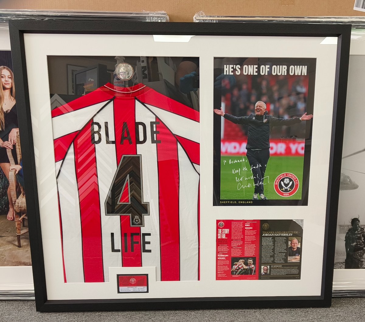

Looks quite simple but had to incorporate silver "medal" (actually had the ashes of the person who was memorialised in there), shirt, poster, season pass card and match programme obituary.
