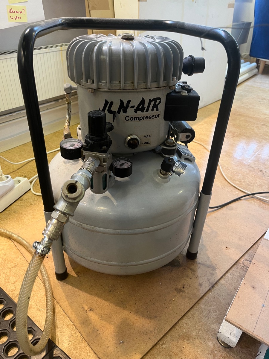

I have this compressor från Jun-Air. It has started to leak air from the compressor itself.
Only holds (?) air for 10 minutes before it starts again.
I have removed the hose (?) so I know it’s the compressor leaking. I have emptied the water. Will try ”water with bubbles” tomorrow when my son comes and help me.
Any known problems? Places I should look? Any suggestions are very welcome.

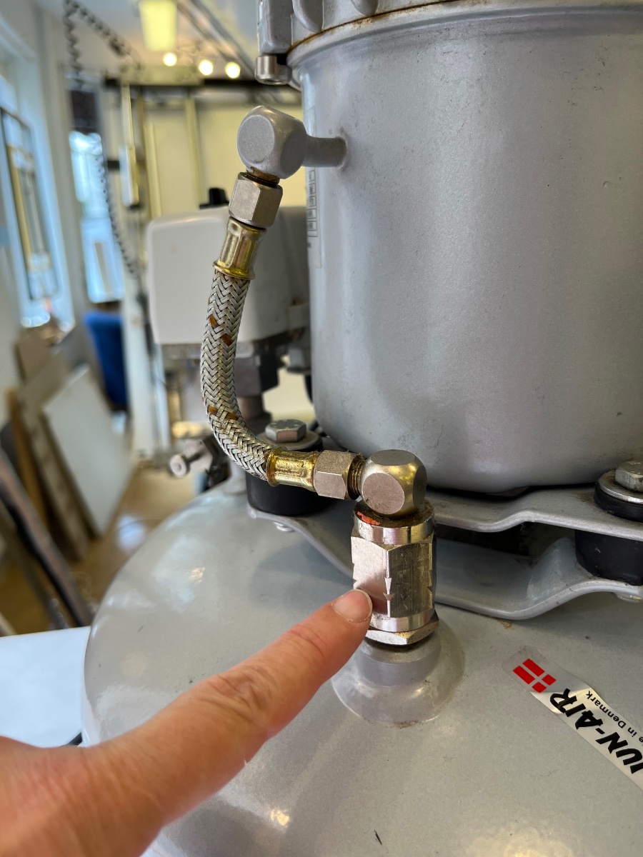

Re: Compressor Jun-Air leaking
I had the same issue with my compressor
Mine is a larger ABAC unit but it also only held air for about 10minutes before it started again
It was a small valve that went into the tank that had perished
Only cost about £30 and it's good as new.
If you have a small pipe from the main unit into the tank try taking a look at where that connects. If it's perished it's not registering as full and turning the unit off. Instead it's running all the time and trying to refill

Is this a valve?
My sons opinion is that this is the thing that’s broken. In Swedish it’s called backventil.
Framer in Göteborg, Sweden
- Posts: 363
- Location: mid wales
That might be it
Take it apart and see if there's a rubber gromit inside.
Worth looking
Worth looking

It was that not return valve (I’m learning a lot of new words) that was broken. Found a company specialised in air pressure and hydraulic just 15 minutes away. So now it’s been almost one hour without starting! Yay!
I’m so relieved! So happy and lucky that my son fixed it.
