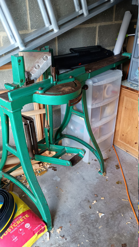

Gillthepainter
- Posts: 159
- Joined: Thu 02 Aug, 2012 2:39 pm
- Location: Cirencester
- Organisation: Crescent Art Space
- Interests: Painting, frame making, sourdough baking
Re: (Too) big first order
Justin
I did have a manual underpinner, foot operated. But as you can see from the front of the garage in the picture = my half, I didn't have room for it.
They do take up quite an area, and I also need to be able to get those ladders out when needed.
So I gave the underpinner to a friend, under the strict instructions that he didn't undo, and fiddle with it. Although it cost me £40 from a chap in Birmingham, it was still a fine piece of kit.
Now this artist (former aeronautical engineer) thought he knew better, and took it apart. And has a piece of metal that will just about feed 1 v-nail wedge, then jam.
I wish I'd passed it on to another person who needs one. It still bugs me, mildly.
