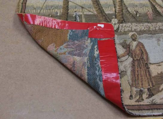

Had this piece in recently, customer described it as a tapestry but looking at the stitching I am not so sure. Anyway as you can see it has been lovingly preserved with gaffer tape to stop it fraying

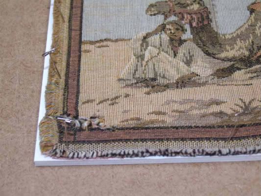

The holes where it had been nailed to a wall (honest)
Rightly or wrongly I left the tape in place. My theory is that the damage had already been done and the most of the adhesive would have stayed in place. Not enough border to lace it so it was stiched directly to 5mm foamcore. Took a while to get everything straight. Foamcore reduced in size after determining where the border would be.

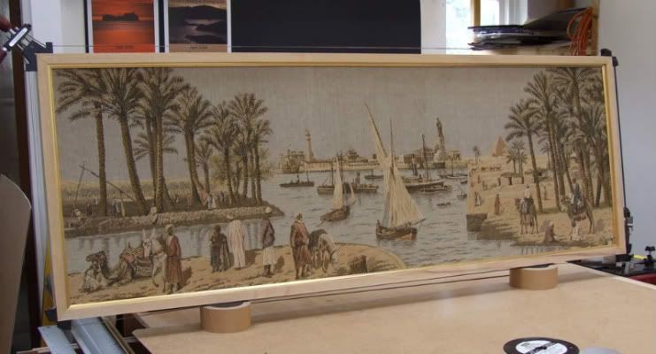

Trial fitting, I was pretty happy with the gold fillet used to cover the stitches and it came out well. About 1400mm long.

I think you were very wise not to try 'improving' it. The whole lot might have unravelled.
At least the way you have secured it will not make it any worse. :D

Ah! Genuine Egyptian craftmanship!
The Crofter wrote:Rightly or wrongly I left the tape in place.
And genuine Egyptian carpet tape! Obviously purchased from one of those authentic dealers in the Bazzar!
All joking apart, even if you could safely remove the offending tape, the adhesive residue would still remain. I also think you took the right course and produced a superb finished job.
A small note inside explaining that it was framed as supplied would have been included if such a job had to have my label on the back.

From what I can see in that image..... It appears to be a machine made (Jacquard loom) product, from the first half of the 20th century and of European origin.

JFeig, you are probably correct about the origin. My customer is Egyptian and when he brought in this piece (and another smaller one) I assumed it was something special he purchased in Egypt. It turns out they came from a bazzar - in Glasgow...
